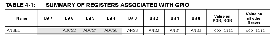

Back again in trouble with this basic stuff. Hope some kind guy can explain why this code doesn't work.
I thought ANSEL = 1 caused the selected input to be enabled as analog in an AllDigital environment'
However, the simulator displays the input as digital . So where am I going wrong?

I haven't used PIC's for a fair while so excuse me if I am wrong.
TRISIO = %00000010 You are setting pin 1 as an input.
ANSEL = 1 You are setting pin 0 as analog.
Perhaps you need to make ANSEL = %00000010 and set pin 1 as analog?

Dawning of a bright light. Thanks to you, Eric, I now realise that I was misunderstanding how to use ANSEL. I imagined that setting ANSEL to 1 enabled all analog inputs, and that all one needed to do was specify a particular one in the Adcin statement. I now also realise what Gobbledok meant (he was absolutely right), and I need to thank him too.
Thanks, Gobbledok, I apologise for not understanding your explanation right away. Of course you were right. Ericgibbs helped me see the light.
