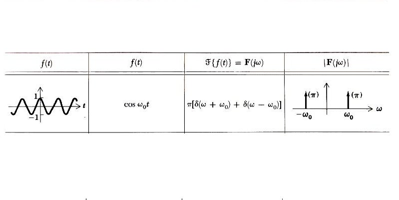

Hi again,
I'm posting an image that shows the frequencies after transforming f(t)=cos(wt). Look to the far right.
Steve:
Yes interesting :)
Winterstone:
Yes, i think i understand what you are saying. But we are still looking for a physical explanation of the impulse shown in the attachment that exists in the negative frequency domain. Look to the far right to the image that has the two impulses. One is on the positive frequency side (first quadrant) and the other is on the negative frequency side (second quadrant). We assume we know what the positive frequency impulse is, but maybe we dont even understand that in it's entirety either. Integrating either side (squared) from zero to positive infinity gives us only half the total 1 ohm energy, while integrating both sides gives us the total energy. So actually neither side explains the whole picture :)
So we're looking for an explanation. I tend to agree however that it's just a mathematical tool. We also use "imaginary numbers" to arrive at real life conclusions, but we dont expect to find imaginary apples sitting on the shelf at the supermarket :)

MrAl, hello again.
I suppose, you will not be surprised that I know the mathematics behind the two-sided spectral representation of a signal (as shown in your attachement).
Yes- we can try to find a physical explanation. But - for me - it would be not a surprise if we fail in some cases. Can we always expect to find a physical explanation for a phenomenon that results from a mathematical manipulation only?
But remember: It is a known fact that the one-sided spectrum (which results from the real form of the FOURIER transform) contains amplitude that are twice as high if compared with the two-sided spectrum. Thus, there is no problem to interpret it correctly.
As explained in my example with the complex frequency (s=sigma+jw) I have no problems to accept that we are using from time to time mathematical tools, which lead to results without direct physical "existence".

Hi again,
I had no doubt that you understood the calculation itself, that was never a question.
Now that i think about it, that could be the whole key. We're trying to understand frequency itself but all we really have to do is understand that the transform is sampling the real waveform of a function using both positive and negative time. Thus it may turn up components both positive and negative.
Looking at the end of the motor shaft again with the dot painted near one edge of the shaft on the end, if we look at it in positive time we see it rotating one way, and if we look at it in negative time we see it rotating the other way. Since physics admits that there is no preference, we get both as valid results.
