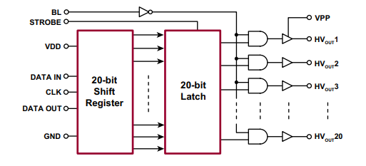

So I've some experience with microcontrollers and making PCB's. I've been really interested in making a PCB for a "physical" display driver(saying physical so it will not be confused with a program). But the problem is, I can't find a single tip on working with the display driver components(Not even the second page of google had any help). So I read the datasheet of the HV5812WG-G display driver. But could barley make anything out of it.

So I want to make a PCB for a display driver, but I have no info on how to program or connect the device to a microcontroller. So would really appreciate it if someone where to help/guide me in the right direction. Or tells me where I can get the info I need.

The HV5812WG isn't made any more, and it's designed for driving Vacuum Fluorescent Displays (VFDs) that are also rare, so you might want to consider whether you want to use it.
If you do use an HV5812WG, it contains circuitry that is easier to understand if 4 parts of it are looked at separately:-
1) On the left is the 20 bit shift register. It has 2 input lines (DATA IN and CLK), and 20 output lines, one for each bit. There is also a DATA OUT line, but you can ignore that unless you are using more than one HV5812WG.
The shift register allows a microcontroller to separately control each of the 20 output lines from the 2 input lines. It's only there to save on number of connections. It allows control by storing the state of the DATA IN line each time the CLK line goes high. Bit 1 has the value, 0 or 1, that DATA IN had just one clock rise ago. Bit 2 has the value that DATA IN had 20 clock rises ago.
2) The 20-bit latch takes the data from bit 1 to bit 20 of the shift register, and either passes it on to the next stage, or leaves the data going to the next stage unchanged. It's function allows the display to remain the same while the data in the shift register is being set up. Usually, after that the STROBE wire is taken high by the microcontroller and the data in the 20 outputs of the shift register goes on to the next stage.
3) Blanking. There are 20 AND gates, all connected to BL (via an inverter). When BL goes high, the display is turned off. This allows the display to be turned on and off without loading the data, that takes a lot longer.
4) The triangles represent drivers that take the output of the AND gates that do the blanking, and use that to enable 20 drivers that a capable of switching the high voltages used by the VFDs

Assuming you want direct pin drive or matrix drive, as for an array of LEDs, as you mention the HV5812:
If the display operates at 5V, then you can use bipolar transistors and resistors, or N channel and P channel FETs to drive high & low sides.
For higher voltages, you can use such as MIC5891 for high side and MIC5841 for the low side.
Those operate in a similar way to the HV5812WG, but each is an 8 bit / 8 output section. They have a shift register for input, easily driven by either an SPI port in an MCU, or software bit-banging.
Once the data is loaded to the shift registers, which can be cascaded through as many devices as needed, a pulse on the strobe pin loads it to the latches, which feed all the power drivers on the output pins.
It may sound slow to send data serially - but the data in can run at several megabits, so less than 2uS per 8 bit byte transferred; eg. a 16 x 16 array with two high side ICs and two low side IC could be reloaded in less than 10uS, with hardware SPI or a fast MCU.
