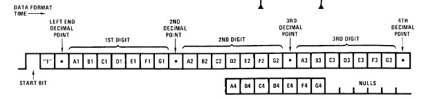

Anybody who has any experience using the MM5453 LCD display driver?
I have built a prototype but I can't get it to work. All segments on the LCD are always on.
Wired it according to the datasheet https://www.ti.com/lit/ds/symlink/mm5453.pdf.
Test code below:

I found you need 37 clocks... Start bit , 32 data bits and 4 end bits... However!!! You also have a sign bit to deal with.
1 start bit, 1 sign bit 32 data bits then 2 null clocks then lastly 1 single clock to initiate the latch..
THEN!!!! You also need to clock the data in on the rising edge..... So load the data_pin first then clock it in

As a guide.... I have the clocks here exactly the same as you..

The clock routine is just a pulse on the CLK pin and y is the decimal place...
No success!
I have tried both your suggestions but still can't get any respons on the LCD.
I also think I have tried all possible combination of clock pulses and databits possible but still nothing:banghead:
I also have checked and measured the wiring over and over again to be sure it is according to the datasheet.
I'm totally out of ideas now.
