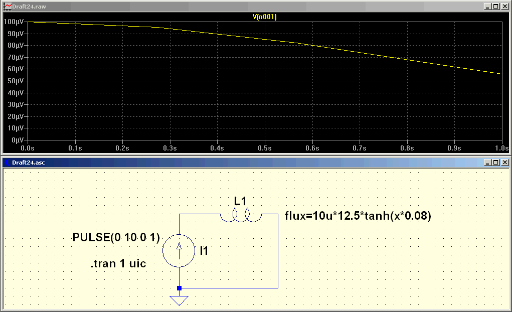

I've Googled around and found some stuff to make LTSpice show the effect of saturation in an inductor, but I haven't been able to make it work.
Just replace the value 10u with the formula below.
(Watch the 12.5 = 1/0.08, x is the coil current)
flux=10u*12.5*tanh(x*0.08)
I think my problem may be with x. I don't get any errors, but it reacts just like a resistor. Can someone help?

hi Ron,
Do you have an asc file to post, might give a shot.
Eric
Like this?
The LTspice 'Help' ..... helps ;)
  • Inductor.asc
God, I am so dense. I kept trying to put something in X.
Thanks.

The tanh() function models the BH curve, with H as the x axis and B as the y axis.
Since H is proportional to the current I, x would be the current through the inductor or at least proportional to current.
If you do a 2d plot of tanh(x) from say -5 to +5 you can see an entire anisotropic BH curve.
This kind of BH curve is called an "anisotropic" BH curve. Unlike a pure inductance that has a perfectly linear curve (straight line) it models saturation, but it does not model hysteresis. It does allow for faster calculations though.
