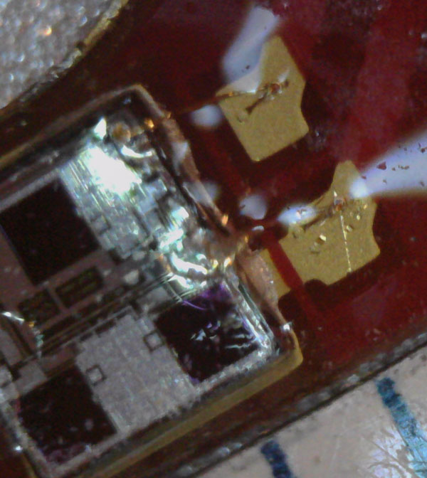

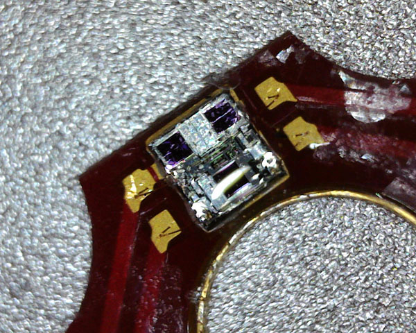

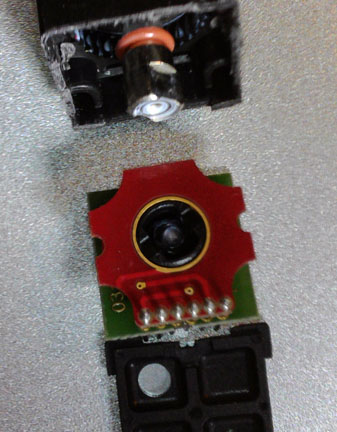

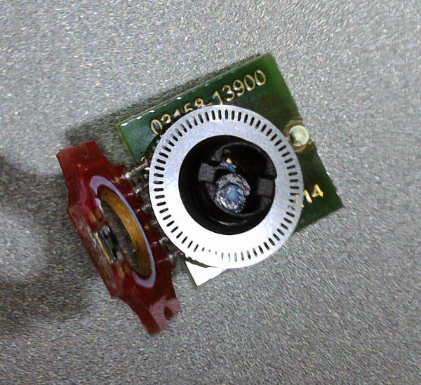

Here's a little follow-up. My first Bourns encoder died an early death, and DigiKey replaced it. I had seen pictures of how they are made, but I decided to take a look anyway. Here are some pictures. One shows the parts right after popping the back off. There is a little pot accessible from the back, but covered with the label. Then there is the LED and detector and a very nice slotted disk. The rule is in millimeters. One photo shows some silicon. I have no idea what it does except act as the photodetector. Maybe it acts like a comparator to give sharp state changes.
Regards, John
View attachment 95519 View attachment 95520 View attachment 95521View attachment 95522
Nice pics. Looks almost like the inside of a mouse.
