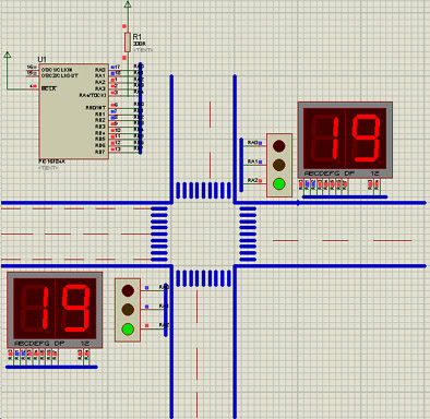

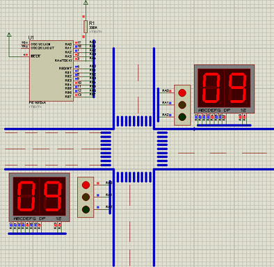

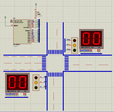

1. Traffic light
I use the pic 16f84 to control three leds with three different color as the system traffic light. The diagram bellow help you see clearly:
Red light
Yellow light
Blue light
* Code for projects
