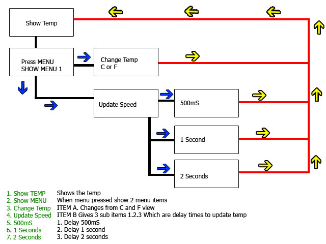

    How would I make a menu like this one:
    YouTube - Menu LCD y PIC16F877A
    I would like to write a menu in c, similar to the one above I am using the pic16f628.
    I am able to have a button display a message and then go back to the main screen but i have no idea how to go any further to achieve the above.
    Can anyone help or point me in the right direction please?

    Only if it was that easy heh.... You should first make A flowchart of how u want your menu to work this way you won't get to confused later on. Once u have done that u can write code to show the menu items fairly simple..
    Since I don't work tomorrow I will take u through a few steps showing u how to make a simple menu. But it will be for my temp sensor. The idea is to teach u how to go about doing it and not just doing ur work for you.

    Here is my menu layout. Draft:
    [​IMG]

    Thanks for the reply. My project is a thermostat so is very close to your example, however I am wanting to learn so am happy for you to just teach me the steps rather than doing it for me.
    I do not fully understand all your code but understand the basic principle of what you are doing:
    First you are waiting for an input and depending on which button is pressed you either increment ITEM or decrement it, when done is pressed ITEM is switched so that the relevant item info is displayed?
    I will have a go at making a flow diagram and see what I can come up with

        return temp1;                 //Return our temp1 var
    void MainMenu(void){
    unsigned char POS = 0;  //Used for cursor ONLY!
    unsigned char done = 0;
    unsigned char x;
    unsigned char ITEM=0;
    Lcd_Cmd(_LCD_CLEAR);
    while(!done){
        for(x=0;x<2;x++){
            LCD_LINE(x+1);
            if(x == POS)
                LCD_DATA('>',1);
            else
                LCD_DATA(' ',1);
            LCD_STR(MainMenuLIST[x]);
        switch(WaitForInput()){
            case UP:
                if(POS>0){
                    POS--;
                    ITEM--;
                break;
            case DOWN:
                if(POS<1){
                    POS++;
                    ITEM++;
                break;
            case ENTER:
                done = 0xFF;
                break;
        // ITEM contains what item is selected
        // POS isnt used incase larger then 2 menu...
        switch(ITEM){
            case 0:
                //Code to toggle C or F
                break;
            case 1:
                //Code to jump to new menu system
                break;
        //Bring our title back.. cuz we are done with the menu...
        LCD_LINE(1);
        LCD_STR((unsigned rom char*)"  AtomSoftTech  ");
    void main() {
         CMCON  |= 7;                       // Disable Comparators
      Lcd_Init();                                    // Initialize LCD
      Lcd_Cmd(_LCD_CLEAR);                           // Clear LCD
      Lcd_Cmd(_LCD_CURSOR_OFF);                      // Turn cursor off
      Lcd_Out(1, 3, "Temperature:");
       do {
        if(Button(&PORTA,2, 1, 0)) {
                 MainMenu();
        } while (1);
