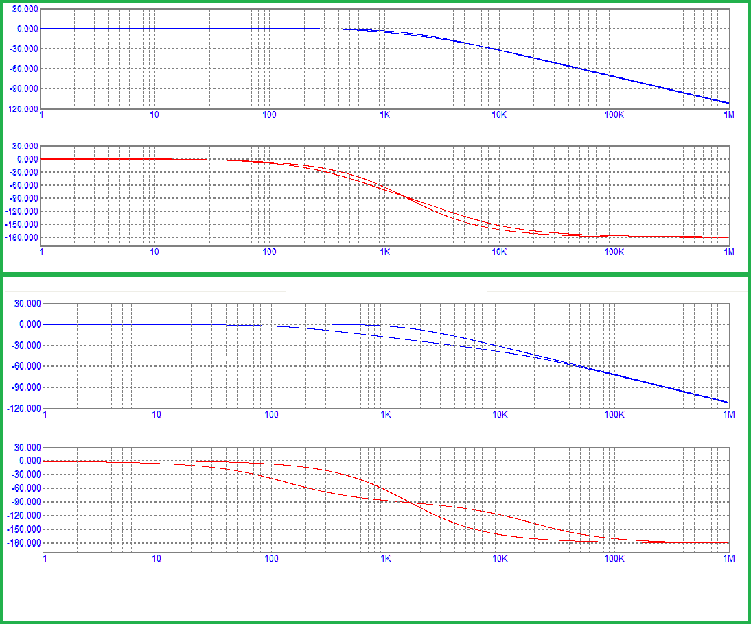

LATER:
The diagram shows the responses for two different circuits. The top section is one circuit, the bottom section the other.
The top graph in each section shows the amplitude responses (blue), the bottom graph in each shows the phase responses (red).
So there are two amplitude responses for each circuit and two phase responses for each circuit.
One amplitude and one phase response is for the circuit without a unity gain amplifier inserted, and the other amplitude and phase response is for the same circuit with the unity gain amplifier inserted.
As can be seen, the top circuit did not change to significantly, although it did in fact change. But the bottom circuit changed quite significantly.
So the conclusion is that sometimes the circuit changes significantly and sometimes it does not change significantly although it does change somewhat. It all depends on the impedances involved. But because it *could* change, we have to assume that it does change significantly unless we can prove that it does not change at all.
