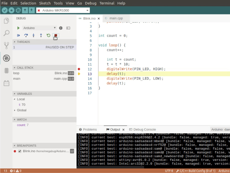

The new Arduino IDE supports debugging.
Regards, Dana.
Can you elaborate on that?
It is beta at the moment. I have not yet tried it.
Regards, Dana.
