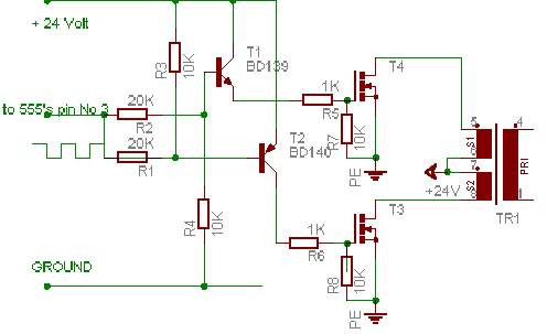

here i attached the diagram i have build.
what i'm sure are.
Occilator works OK
Mosfets are OK ( i Have tested each one seperately ) but only one of them which drived by NPN transistor gets hot in a short time ( 1-2 minutes then after burns ) both are fully turns on and off.
i've got to mention a thing is that as for testing i have connected 2 leds
and lit them like a flipflop i have observed that the one fed via NPN transistor lights brighter then fed by PNP transistor. assuming PNP transistor causing more voltage drop then NPN ones.
Since Mosfet drived by PNP transistor works grate i just think ( it might be wrong ) may be i should put grater resistor to the gate of the mosfet which
fed via NPN transistor ( Burning one ). i'm not sure that this will be the solution. i'll give it a try. or i should use another occilator
any suggestion please
thanh you.

i got a question, why do you use the BD139 and 140 transistors?
the 555 can drive the power tr mosfets by itself. and why did you use such power transistors(BD....)?
i had no special reason for using BD type transistor i was just intendet to use NPN and PNP transistor. and may be i thought it would be better to use little powerfull transistor to drive mosfets. if this is wrong i can try less power transistor like BC type
555 should be able to drive mosfets by itself. but it can triger N channel mosfet at positif edge of Square wave. so i should have also use P channel Mosfet for negative edge of the SW. and i have decided to use transistor. I've got use one or another. isn't it ok...???

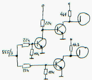

I think the 555 supply is 15V(datasheet).In this case the PNP transistor always conduct. See this circuit.

I think Sebi has it there.
You have a potential from the 555.
Try a decoupling capacitor,
maybe around five to ten MFDs
John
The capacitor distorted the signal rising an falling edge, in this case bad choice: if the FET-s become slowly rising signal, also burned.
See my small modifyed circuit: here You can run the 555 from 5...15V, while the output sage working on 24V. In the original circuit was a problem with PNP stage: it can never closed, because 555 out in HI only 15V and in this case always remain 9V for open the PNP transistor.(it open 24V minus 0.7V!)

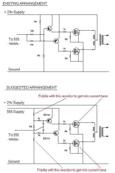

I think that the resistor chain R3,R1,R2,R4, thats
10K,20K,20K,10K, is wrongly valued.
Consider the voltages, of the chain without T1 and
T2 connected.
That would be 4v,8v,8v,4v, across the resistors.
I would expect that T1 and T2 would be well into
current with that chain applied.
This wouldn't actually matter if the drive to them
was enough to fully close each in turn, which i dont
think it would be from a 555.
I would be inclined to alter that biasing setup
until both T1 and T2 were closed, and include base
stoppers like the output stage, with two capacitors
from the 555.
If the 555 is run from a lower supply rail,
and i suspect that it is,
then the drivers should also be run from that rail.
If the 555 is being run at 24v it may be alright
for a while, but you should not leave it like that.
Here's a suggested alteration, i didn't really
get what Sebi meant about the capacitors,
i guess about five to ten MFDs, maybe a bit less.
On the diagram, ive put min current, for here that
should be only a bit away from conducting, i'm sure
you know that.
Best of luck with it.
John.
