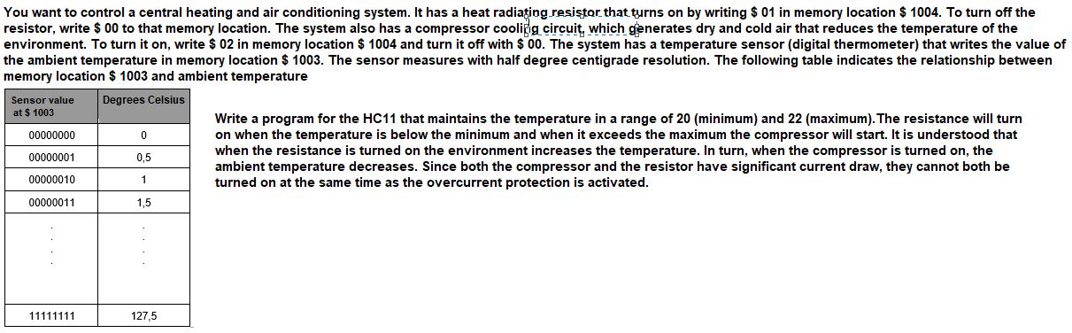

I'm programming an old 68HC11; i was reading a chapter related to interrupts and i got stuck in 2 "suggested" exercises.
Who can help me with some assembly code?. This topic is kinda tricky to me and everything seems a little complicated.
EDIT:
I can think of 1 or 2 ways to solve it by using C or even C++; i'm using THRSim11 and it seems really complicated. I need a 68HC11 hero. Who's willing to help me?

The initial question re. interrupt handling has no real correlation to the problem in the added image - that can be done completely with a simple loop:
Read the temperature, compare to the target, switch heat, cool or both off as appropriate & repeat.
This is an example of an HC11 interrupt routine, in assembly.
In essence just a subroutine, with any registers you use in that routine saved at the start and restored at the end, so whatever they were being used for at the instant the interrupt occurs is not affected.
