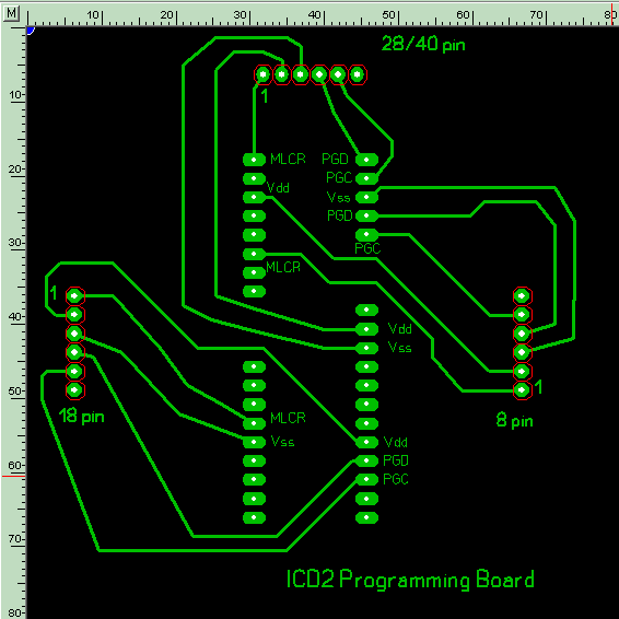

Hiya Guy's,
Below is a layout of a programming board designed to be used with the ICD2 programmer/debugger. Basically it's only for programming 8,18,28 and 40 pin pics. Although I've been thru checking it a few times I reckon it pays to get a second opnion just to make sure I got it right. I'll be using a 40 pin zif socket and the spaces between the unsed pins I'll cut off to give plenty of clearance for the tracks.
Cheers Bryan :D
As usual the PGM pin gives a lot of troubles as Microchip moves its position around. You need to ground this pin during programming.
On 18F4455 and many 18FXXXX 40-pin PICs, this is on pin38. On 16F877 this is on pin36. On 16F876, this is on Pin 24. On 16F628A, this is on pin 10. On 16F88, this is on pin9. I'll let you work out their relative positions on a 40 ZIP socket.

Hiya L.Chung,
Eh mate I'm not doubting your quote above but a question came up on the sparkfun forum about the ICD cable and the pgm pin, so I asked the question on the use of the pgm and the following is the answer I recieved
The PGM pin does not need to be connected when using high voltage programming. It is only used when you enable low voltage programming (LVP) in the PICs configuration bits. The ICD2 and just about every other programmer out there is a high voltage programmer so you can ignore the PGM pin unless you intend to use the LVP feature of the PIC.
So now I'm abit confused :shock: . On reading up on the ICD2 users guide in which I refered to when I made the circuit design I didn't see any reference to PGM so that's why I didn't include it on the board. So I'll go right thru the guide again to double check but do you think that quote is correct?
Cheers Bryan :D
The requirement of grounding the PGM pin is generally what I have read as the solutions/suggestions where people are running into difficulties in programming a PIC using HV mode. A floating PGM pin would easily put the PIC into LV programming mode(if the PIC's LV mode has been enabled in the config) and then one might not be able to place it in HV programming mode.
How true is that I really don't know because I always ground the PGM pin during programming. Perhaps others can put in their comments here.

Don't be. What if I tell you that some new PIC comes with LV programming mode enabled by default?
I think ALL LV programmable PIC's come with it enabled (or at least did at one time!), otherwise you can't program them with a LV programmer.
I ran into some problems with PGM with 18F2620 just recently, if the pin wasn't grounded, the PIC failed verify (and I made sure LVP bit was disabled). I think it's because the PIC is erased first (including config), programmed verified and the config bits are programmed last. Therefore there is a window during programming when the LVP is enabled and is causing problems. (I was doing ICSP).

Hiya Guy's,
On reading the ICSP users guide I found this section on the PGM.
2.4.1 LOW VOLTAGE ICSP

So I guess this means if I clear the LVP bit in the config word and use the ICD2 in programming mode which is HV mode it should program. Well I might have to set up a zif in a breadboard and try it as I don't want to etch up a board and find I've got to change it.
As this is a big learning experience for me if I end up needing to include the PGM pin please don't say I told you so :oops:
Cheers Bryan :D
I'll try to repeat the main points again, as confirmed also by what you've just quoted.
1. When you want to program any PIC, you need to erase it first. But erasing the PIC include erasing the config memory too.
2. The content of the whole PIC memory, including Config memory 'bit' which determine the programming mode become all "1"s. The result of this action is to enable LVP mode on those PICs that have LVP available.
3. As soon as this happens, if the PGM pin is floating, there is a good chance that the PIC enters LVP and causes error in subsequent programming results.

Hiya Guy's,
Well I finally got around to hooking up the ICD2 to my laptop and after re-configuring the usb drivers it works like a charm. Rather than make up a programmer board I'm just going to use a breadboard for now and the first test a simple led flasher program worked first time :D :D :D . So now I can finally get some serious pic work done and be able to debug it thru mplab too. Well the programmer board can wait awhile and I might farm out the etching as a double sided board would be the go and I'm not even going to try and attempt a double sided board with press'n'peel, anyway thanks for the support guy's :D
Cheers Bryan :D
