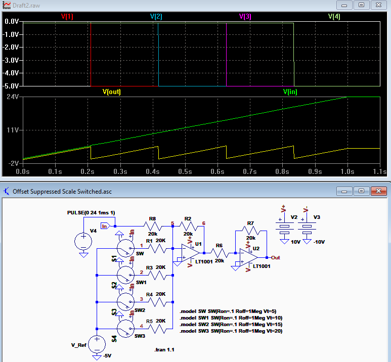

I have a 0-5V input ADC and need to measure voltages between 0V and almost 24V. I need to do this without altering the resolution. So a simple resistor divider is out. I was thinking of using an opamp in a differential mode, with one input hooked to a resistor divider to input different ranges (0, 4.5, 9, 13.5, and 18). Starting at the highest range, if the ADC reads 0 then move to the next lower range until the ADC returns a reading.
It looks good to me on paper. I am now working to find an available opamp to fit in the circuit. As the inputs will be 0 to 24v, I think the power supply will need to be the same. The output will only be 0 to 5v, so plenty of headroom on the high side but will need to include Vee on the low side. I might be able to get a supply with -Vee but the opamps I have seen are specified +/-15V dual supply or +36v single supply. What happens if I use -5v and +24v? Smoke?

I chose the 4.5V steps, so as to provide space for hysteresis in changing offsets and avoid getting to near the rails. 4.5V is not fixed, but easy to calculate. I was going to provide hysteresis thresholds 100mV apart and 100mV from the rail. In a voltage rising scenario, upon reaching 4.7V change up an offset level, that would then provide an ADW reading of 0.2V. If the ADC reading then drops below 0.1V, then drop down an offset level making the ADC reading 4.6V.
It just occurred to me, they make 18V and 9V voltage regulators. That would provide two of the steps, 4.5V is half of 9, a simple resistor divider, 13.5V is more tricky but easily derived from the 18V regulator.

I meant you scale the input offset from a lower voltage reference.
Below is the LTspice simulation of my concept to do that.
It sequentially switches in another resistor from the 5V, V_Ref to the summing junction of U1 at each 5V increment of the input to offset the input voltage.
The actual circuit will, of course, need some comparator circuits to do the switching.
You will likely also have to overlap the switch points with some hysteresis to avoid dead spots and dithering, which may require adding an extra range.
You can buy 20k ohms resistor networks that have precise matching to minimize errors from the resistor tolerance.
