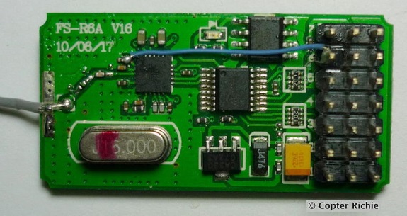

Use a coax cable from the receiver to a suitable antenna socket on your ali box.
Look at this pic taken from the interwebs:
I guess that your receiver looks like this.
Make the coax connections as short as possible, as shown in the picture.

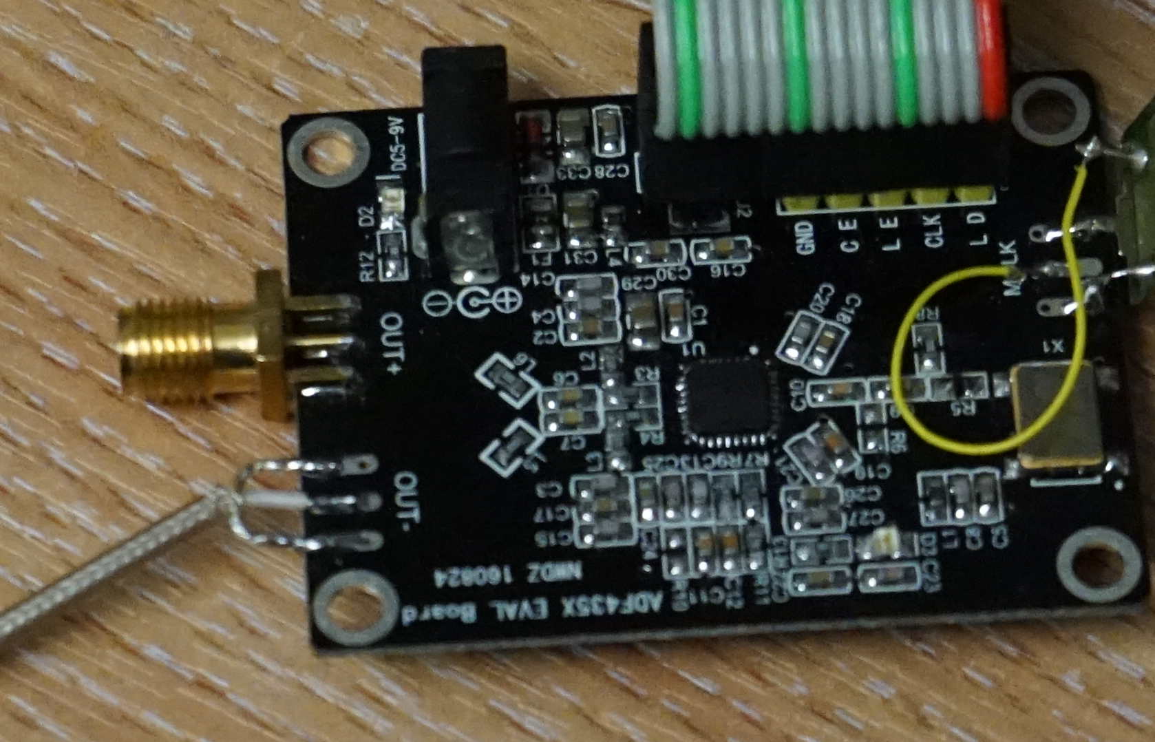

It is even better if you connect half the coax braid to the groundplane on one side of the connection, and the other half of the braid to the groundplane on the other side of the cable.
Like this, but shorter if possible:
