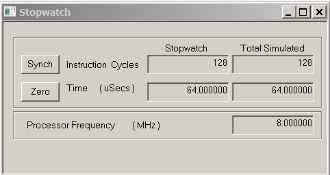

I have downloaded MPLAB IDE v3.10 i dont have any PIC kit to check this code of application. what is the best meathos of debugging this assembly language code. I read the guide book on simulator but it is old version i want understant it step by step to learn do you guys have any particular book or site to refer me that will be helpful

You really need a later version of MPLab IDE. Version 8.92 is the current and last version. There are probably some tutorials for the earlier version still on the Internet.
As for counting machine cycles, that is most easily done by using the stopwatch function in MPLab SIM debugger. It can be done manually, and the instruction set summary will give the number of cycles for each instruction. Simply put, most instructions are one cycle; instructions that require changing the program counter (PC) (e.g., "goto" ) take 2 cycles. Programs that can branch (e.g., btfss) take 1 cycle unless they branch/skip, which then takes 2 cycles as the PC is changed.

To use the StopWatch, you need to be in debug mode. Place a breakpoint where you want to start and where you want to stop. You cannot put a breakpoint on a label, so I put the two breakpoints at the first step (movlw 0x20) and at the very next step after the loop is exited. If you put a breakpoint at "goto RAM_loop" you will only time one pass through the look. The default mode for putting a breakpoint is to double click on the line. Here is the StopWatch:

Actually, I find using StopWatch fun and sometimes use it just to amuse myself.
