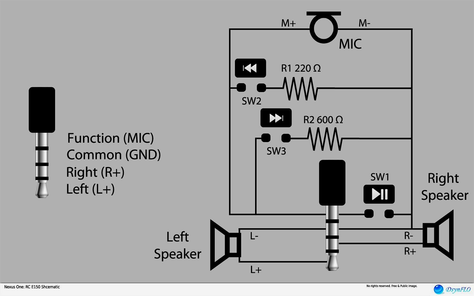

do you think I could get this mic working externally and test it with my phone? Power the board with 5v and ground, hookup mic to the other 2 wires?
I'd not try that, the voltages or signal levels on the amplified connections may damage something intended for direct connection to an electret capsule.
The two wire mic capsule on its own should work if directly connected to the appropriate contacts on a four-way (trrs) 3.5mm plug.

Dynamic mics are not polarity sensitive and do not need a bias voltage. Any mic capsule with a voltage on it means it's not dynamic...
Note that dynamic mics also have very low DC resistance; the specs for a typical phone mic input require a relatively high resistance so the remote controls, when used, put a readable finite resistance across the mic input - eg:
