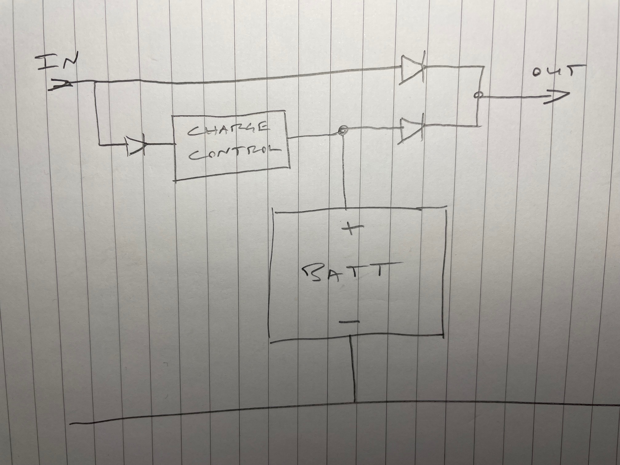

The battery is functionally "between" the external supply and load, but not literally.
It's a very common application, the same as for things that use external charging power while they are operating.
Example - excuse the back-of-a-beermat quality diagram!
This is a general style of such a configuration, that I've used many times in both projects and products. With no external power, the battery feeds the load (or more likely load voltage regulator) via the lower right diode.
When external power is present at the input, that is routed directly to the output via the upper diode and the battery out diode is reverse biassed so nothing is drawn from the battery.
At the same time the charge control is powered to recharge the battery. That would also have a ground and possibly other battery connections, and the diode in line with that could be at the output rather than the input - but you can hopefully see the principal.

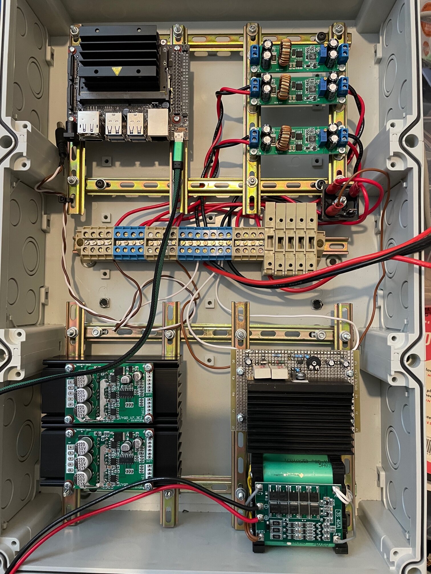

And this project-in-progress uses that type of setup - the main power is from 20V or 40V packs, but it also has a 10V / 12V (three cell lithium) battery to maintain power to the electronics if the main batteries are disconnected.
One of the regulator boards at the top right reduces the input to 15V which feeds a configuration similar to that above, except the charge diode is at the output of the charge controller.
The lower right heatsink & components on the matrix board are the charge controller - an LM1086CT set to get the correct voltage after the diode, with a current limit added using the ceramic resistors for sensing.
The electronics battery pack is below that, with a protection / balance board attached.
The "diodes" ae actually a power bridge rectifier just below & right of the upper voltage regulators. The output of the battery circuit feeds another regulator which provides 5.1V to the Jetson Nano at the top left.
The third regulator is for other 5V parts such as interfaces for the BLDC drivers at the bottom left, still to be built and fitted.

1 - 3: With the type of setup in my drawing, there is no "switching" - if the external supply cannot give enough current for the load at any instant, it's voltage will be pulled down until the battery output diode starts to conduct and the remainder of the load current drawn from the battery.
And the reverse - as the external power increases (eg. from the solar panels, in your case, as the sun comes out) the load on the battery would gradually reduce until the external power supplied it all, then the excess would start to be used to charge the battery.
4: If the input power is adequate for the load with 4A spare and the charge controller can handle 4A, there is no reason why not.
The solar regulator needs enough voltage out to feed whatever battery charge controller you use; something over the full-charge battery voltage. I use around 2V more in the setup in the picture, so the LM1086 always has more than its minimum voltage, allowing for the extra 0.6V diode on its output.
In your system I'd suggest suitably high rated schottky diodes to minimise the voltage drops (and power loss).
It should be possible to shunt the diodes that feed the load with power FETs, controlled by voltage comparators, to virtually eliminate those diode losses.

Look where the charge control block is on my diagram.
(And note a "protection board" is not a charge controller - and note you must use a combined protection and balance board with a multi-cell pack; that forms part of the battery assembly and the overall unit is the "battery" in my diagram - and likewise the lump in the bottom right corner of the photo, with the cells (green) just visible around the edges of the protection/balance board & two wires connecting it).

Re. your new post - do you know what a diode or rectifier is?
Look at the diodes and current paths in my diagram. The battery charge path is totally separate to the load path when adequate power is available at the input.
The charge current and load current are completely independent.
