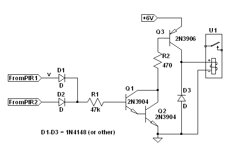

Here's how I would do it, with the PIR near the door set for ~1min delay, the other PIR set for max delay, both PIRS set for continuous trigger mode. D1/D2 form an OR gate.
I don't see the need for the counter or any latch. The light would go off ~3 mins after the last movement was sensed.
I made it on the breadboard. had to replace few resistors. May be i was using 5V instead of 6 as you suggested.
Not surprised. Transistor gain and relay choice determine those. Hope it works as required.
