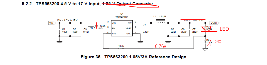

I know these parts are small and hard to work with. Here is a way to get from( 6 to 16 volts) to about 3 volts at just under 1Amp.
The IC is a buck down PWM. It will send current at the LED until there is 0.76 volts across the current sense resistor.
Note: it is controlling current not voltage.
