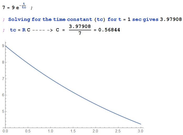

OK, let's take a typical example. Suppose you don't want to go below 7 volts. If you still want to supply 1 amp at 7 volts, then your load is around 7 ohms. Use the equation below to determine the time constant, and then the capacitance needed.
So you need over a half farad to sustain one amp for 1 sec assuming the voltage drops from 9 to 7 volts. You can see from the plot that after 1 sec at 1 amp, the voltage is down to 7 volts.

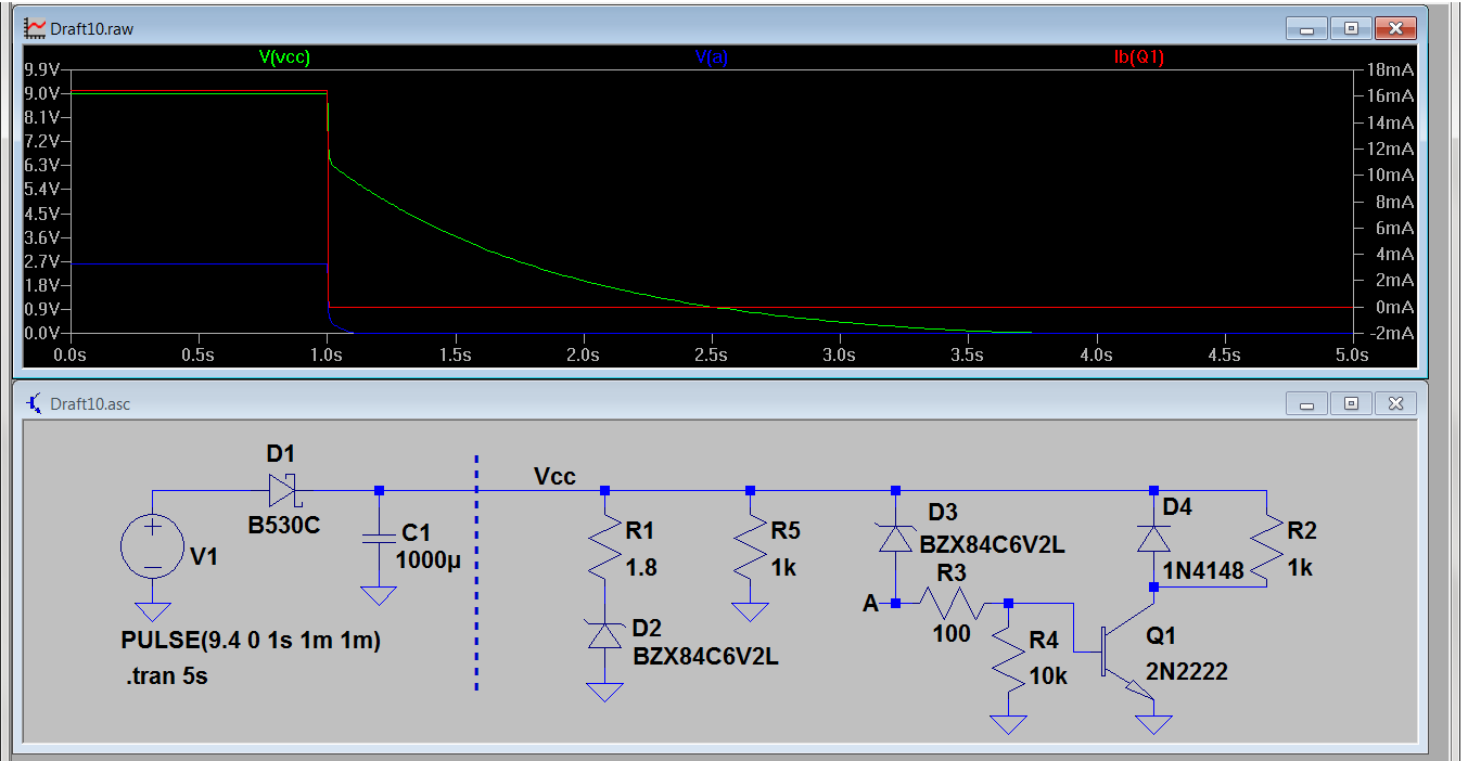

I would suggest looking at your relay drive circuit.
The typical release time of most relays is under 10 milliSeconds. If you're seeing 1 second, then there is something else going on. I suspect that the cause might be the oft overlooked fact that most relays will stay engaged even when the voltage has fallen to as low as 15% of it's nominal voltage.
If your 9V adapter feeds your relay as well as a 5V regulator, then your regulator will shut down fairly high on the unpowered RC curve of the adapter, but the relay will stay engaged quite a bit longer.
If that is what you've got, then you want to speed up the release time of the relay. I would place a NPN transistor in the negative leg of the relay, Feed the base with a small resistor and a 7 or 8 volt zener. That should cause the relay to release much faster.
If that isn't what you are doing, then please post a schematic.

The included simulation shows what I think may be going on. V1, D1 and C1 represent your power adapter. R1 and D2 aproximate your 5Vplt supply and its 1 amp load. R5 represents your relay as it is now. In the simulation the adapter power is cut at t=1 second. At that moment Vcc (the adapter output) drops rapidly down to the level where the voltage regulator cuts off. I don't know what your circuits thresholds are. In the sim I've modeled it at about 6.5 volts. From that point Vcc now drops much more slowly being discharged only by Relay resistance R5. As I said before, relays stay engaged down to ~15% of nominal. If that point for your relay is bout 2 volts, then it will hang on for about a second past the power supply cutoff point.
The circuitry to the right shows a revised relay drive circuit. By shifting the voltage at point A down by the zener D3, transistor Q1 is turned on, but fairly close to it's turn off point of ~0.6V. as such, Q1 turns off, and the relay it drives, at effectively the same moment that your 5Volt supply does. While much faster than it was, this may still not be fast enough to keep your device from rebooting. That will depend on how much capacitance you have on the 5Volt line.
If this still isn't enough, then there re a few other circuit changes that can be done that will ensure the relays switch slightly before the 5V regulator drops out.
Note: Component values used in my simulation are estimates only, and may not match, or be suitable for, your actual hardware.
