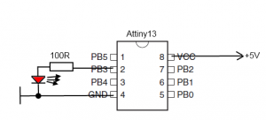

Here is my "Hello Led" for Attiny13
- Package: 8-PDIP or 8-SOIC
- Compiler: avr-gcc 4.8
- Language: C
C:
void main(void)
    /* Port B pin 3 as output */
    *((char*)(0x17)) = 0b00001000;
    /* Port B pin 3 high */
    *((char*)(0x18)) = 0b00001000;
    /* Infinite loop */
    for(;;){}
