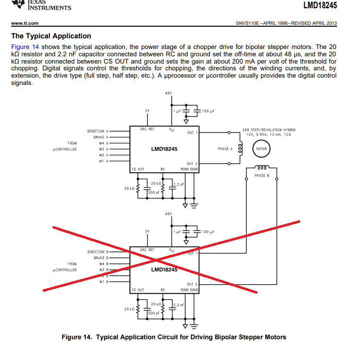

How about this bridge driver.
It's rated for 3A and uses MOSFETs instead of BJTs so it has much lower power dissipation than the L298 device, thus it doesn't require as large a heat sink, and it also has overcurrent protection.
Hi crutschow, this looks exactly like what I need. Upon reading the data sheet, I cant seem to find my footing with the electro-speak. It refers to M1-M4, am I trying to form a pulse with these wires? Page 15 of the datasheet shows a typical stepper motor application, but since my motor is a brushed 24V DC motor would i simply eliminate the bottom half?
Will keeping the suggested resistors and capacitors get me the overcurrent protection?
Yes, data sheets can be a little imitating at times.
The Application circuit you mentioned is for a 2-phase chopper driver, which you are not doing.
You application just requires a steady application of voltage in either direction.

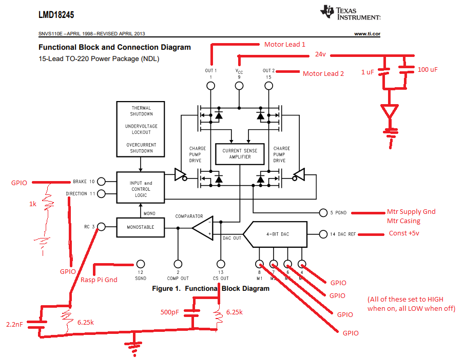

Hi crutschow, thank you for this information. Based on your assistance, I have drawn up the schematic as follows:
Does this look correct to you? To drive the motor, I would set all the 'M1-M4' pins to HIGH, and LOW to turn off the motor? As for the brake, I assume I would add a 1k pull up resistor just before ground on pin 10 for an emergency brake? Just checking.
The CS Out pin, does it need to be connected to anything? What is it for? I cant seem to understand the 3 Rc circuits, and why they are needed, but I am VERY happy that at least I can get the project off the ground!
I missed needing to turn the motor on and off.
That can best be done with the Brake Pin 10 set to 5V for OFF and 0V for ON.
You can leave M1-M4 connected to 5V at all times.
Otherwise looks OK.
You have it connected to the 6.25k resistor and capacitor, which is correct.
Don't understand why you asked that question(?).
The RC circuit at the monostable output determines the time the current is shut off to the motor when an overcurrent is detected, before it is turned back on.
The RC circuit at the CS Out is part of what determines the current limit.
What's the 3rd RC circuit?

crutschow I meant the COMP Out which is not connected at the moment.

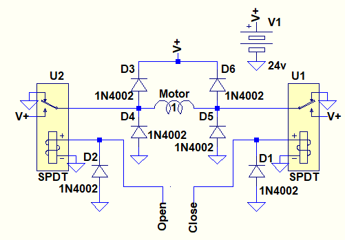

Can I get the bidirectional control with relays?

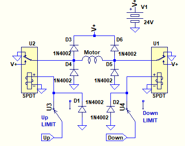

Yes, you use two SPDT relays in an H-bridge configuration.
Basic circuit below:

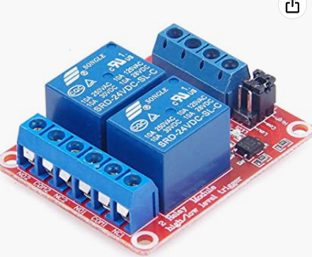

Edit: Here's an example of a dual relay module that should work.
You would need to add the D3 through D6 diodes to protect the relay contacts from the motor inductive spikes.
If you will use limit switches to stop the motor at the ends of the movement, here's the relay circuit for that:

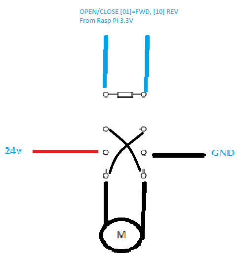

I have been studying your bridge diagram, is it the same as a DPDT like what this guy is doing? I may have jumped the gun here and purchased DPDTs. I had been so patient up till now not to buy anything, but I got too anxious. Is it still possible to do what you are saying with this module? Will I still need to add diodes? Below is a diagram of how I imagine it being wired up, but I have seen other wirings for this module. Can you suggest the diode locations as i have tried to figure it out but cant.
The HiLetgo 2 Ch 24V relay seems to have a coil voltage of 24v. I will signal the coil from the Rasp Pi for the system to turn on, right? Max output voltage there is 3.3v, am I understanding the coil purpose correctly? For the DPDT setup, would I set the GPIO inputs to the coil as [01] or [10] for motor polarity? THANK YOU.
Not sure why you went off-script to some YouTube approach, when I showed you what to do(?).
No, it should be apparent, it's not like my diagram.
The DPDT approach only reverses, the motor, it doesn't start or stop it.
That's why I used two relays, so the motor can be started and stopped, as well as reversed.
You need two relays, no matter how you do it.

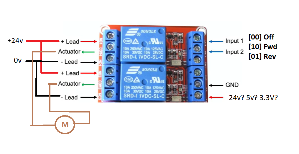

Yes, you need diodes to protect the contacts.
The diodes go to the motor connections as shown in my diagram.
The relay is operated from 24V, but that module has a control input opto isolator that requires 5mA of current, and can operate from a low voltage (the details of that aren't given in its description).

Here is what I came up with after a lot of research on the suggested module. I am not clear about the input voltage at bottom right, I could not find any information about this connection. 1) Is it to power up active board components? Would this be set to 24v?
2) I am surmising the input values (3,3v from the rasp pi) would have the suggested behavior? [00] Off, [01] Dir 1, [10] Dir 2
3) Can you provide diode locations?
That is similar to, but not the module I referenced.
It is has two sets of terminals on the input (right) whereas mine only has one (below).
Also it's not clear what your module coil voltage rating is as that seems to be blurred on the relays.
So please use the one I referenced, or give me a reference to yours.

If you are using limit switches then they also need to be shown (as per my post #13).
The diodes connect as follows:
Two diodes, one from each actuator lead with cathodes to +24V
Two diodes, one from each actuator lead to with anodes to 0V
You are so observant. In my effort to understand this module better, I could not find a datasheet, only this website. It has a -05v- in the part number, so I erased it since it is not what you suggested. What is the bottom right potential for (post #17)?
I looked at the website and did not see the module you posted.
You should be able to control the relays with your 3.3V signal, but I'm not sure until I see a manual on the module.
