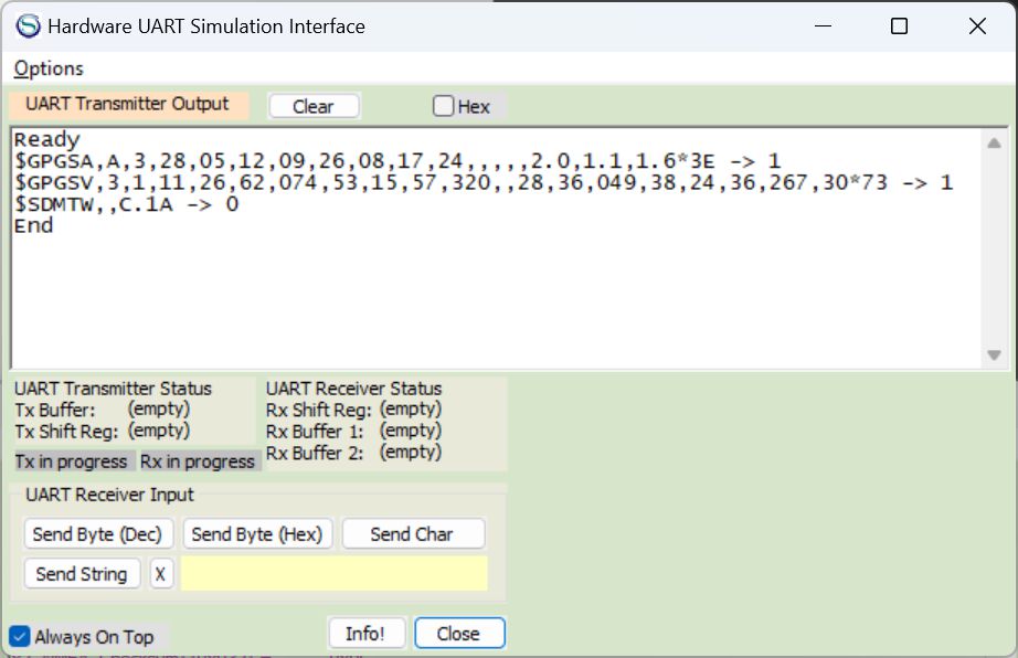

Hi R,
Ok, is it possible to add a checksum to a GPS NMEA sentence, $ to W?
C
You don't 'add' a checksum, it's sent out by the transmission, and you compare it to the checksum you yourself calculate from that transmission. If the checksums don't match, you reject the transmission.
But, as far as I'm aware, the NMEA strings are really long, so you could be struggling for memory to process them?.
I have had to work with NMEA frames several times but I have not had to process them.
'Function for validating nmea frames.
'Returns 1 If the size Checksum is correct.

Function _NMEA_Checksum(_string As String) As Byte
Symbol _Return = _NMEA_Checksum
Dim _Ck_h As Byte
Dim _Ck_l As Byte
Dim Checksum As Byte
Dim x As Byte
Checksum = 0
x = 0
_Return = 0
'Calculate the checksum and locate the checksum of the frame.
While _string(x) <> "*"
x++
If _string(x) <> "*" Then Checksum = Checksum Xor _string(x)
If _string(x) = 0 Then Exit 'Reaches the end of the string, exits the function.
Wend
'Extract nibbles from checksum
_Ck_h = _getnibblehb(Checksum)
_Ck_l = _getnibblelb(Checksum)
'Passes it to ascii value
If _Ck_h < 10 Then
_Ck_h = _Ck_h + 48
Else
_Ck_h = _Ck_h + 55
Endif
If _Ck_l < 10 Then
_Ck_l = _Ck_l + 48
Else
_Ck_l = _Ck_l + 55
Endif
'If the checksum of the string is equal To the calculated one, it returns 1.
If _string(x + 1) = _Ck_h And _string(x + 2) = _Ck_l Then _Return = 1
End Function

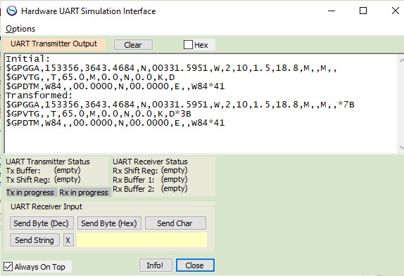

Adds checksum:
'Adds string termination and the two checksum digits to the input string.
'Input value a string variable with NMEA format.
Proc _NMEA_Checksum_Add(ByRef _string As String)
Dim _Ck_h As Byte
Dim _Ck_l As Byte
Dim x As Byte
Checksum = 0
x = 0
If _string(0) = 0 Then Exit 'Empty string, exit the function.
While _string(x) <> 0
x++
If _string(x) <> 0 Then Checksum = Checksum Xor _string(x)
If _string(x)= "*" Then Exit 'Has checksum, exit function.
Wend
_Ck_h = ShiftRight(Checksum ,4)
_Ck_l = Checksum And %00001111
If _Ck_h < 10 Then
_Ck_h = _Ck_h + 48
Else
_Ck_h = _Ck_h + 55
Endif
If _Ck_l < 10 Then
_Ck_l = _Ck_l + 48
Else
_Ck_l = _Ck_l + 55
Endif
'Adds NMEA data character termination.
_string(x) = "*"
'Adds the two Checksum digits.
_string(x + 3) = 0 'Updates the end of string indicator.
End Proc
I'm thinking it would be good to open a new thread with examples.
x++
Wend
If _Ck_h < 10 Then
_Ck_h = _Ck_h + 48
Else
_Ck_h = _Ck_h + 55
Endif
If _Ck_l < 10 Then
_Ck_l = _Ck_l + 48
Else
_Ck_l = _Ck_l + 55
Endif
_string(x) = "*"
End Proc
