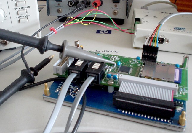

Has anybody seen this before:
Basically the PIR1.RC1IF flag is not being cleared by reading RCREG1 and I can't see any way this could happen.
The device is a 18F6622 and the code was ported working from a 16F887.
I've tried every configuration change that I can think of and checked that the assembler code does what I think it should.
However after the first byte is received the flag goes high and a loop of RCREG reads doesn't ever reset it.
There's no further serial data coming in and I check the error flags.
Any ideas?
Thank you.

It's on a real device.
The code to detect an error never happens. It's just one of the many things I added to try and get a clue.
I looked at the code Hserin compiles to and it's very simple.
It just tests PIR1.RC1IF and waits for it to be set, then reads RCREG, which should clear RC1IF, but doesn't.
So it just drops through every time and doesn't really wait for an input.
The signals are the right way up, the baud rates are correct and there are no errors getting flagged.
I know that this can't be a common fault on the device and there must be something I'm missing, but I can't think of anything else to try.

The offending item:
Look at the BAUDCONx bit 6 (RCIDL) for a low to high transition when a byte is received.
Solved!
Worked through the first 304 pages of the data sheets and trying anything that might be relevant as I went.
CONFIG4L.7 = 1
Turn off background bebugger
I have no idea why this works, as I'm not using RB6 or 7 for anything.
