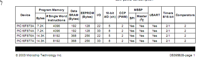

For PIC's the actual code memory is only half the size of the datasheet memory specified, this is because a program word occupies two bytes.
RAM is not ROM, your MCU has only 1K RAM and depending on your compiler it may not be all available for user programs.
