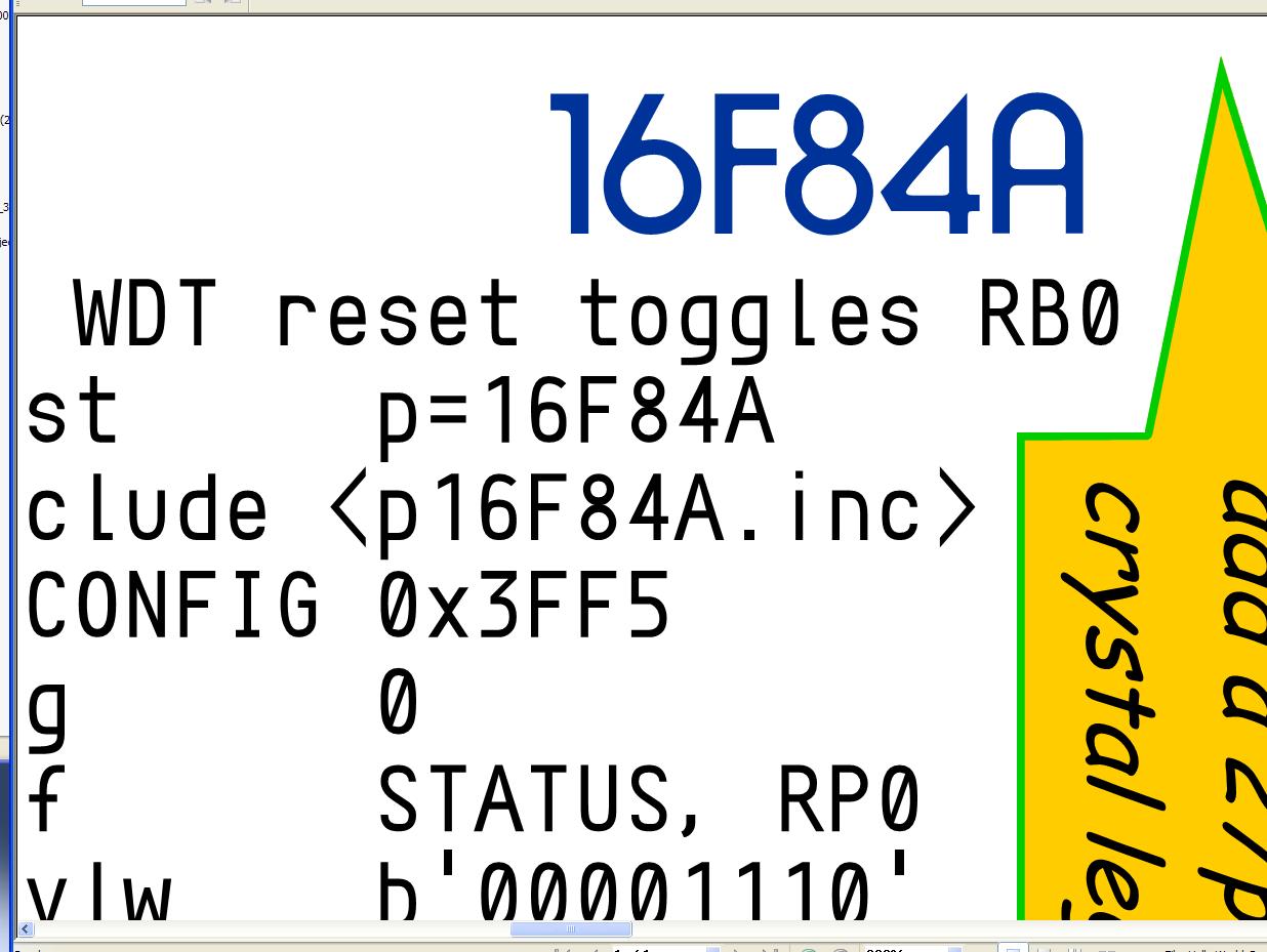

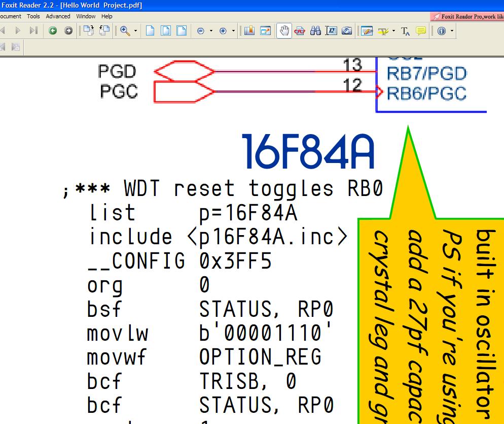

Thanks Dusan, Bill, the hello world poster, how am I supposed to read it? When I download it, I zoom in but it gets blurry, copy and paste and it messes up everything. Am I doing something wrong?
It should open a PDF.
Hm...Try to copy this into folder where is your project...Then build it!:)
Make new text document,and Copy this text..Paste in document,and save as P16f628.inc (Dont forget .inc)

PS like futz said, simply zoom in the PDF.

Here you go, it's for the 16F628A but change it to 16F628 and reassemble it and it should work fine.
;*** WDT reset toggles RB0
  list p=16F628A
  include <p16F628A.inc>
  __CONFIG 0x3F34
  org 0
  bsf STATUS, RP0
  movlw b'00001110'
  movwf OPTION_REG
  bcf TRISB, 0
  bcf STATUS, RP0
  movlw 1
  xorwf PORTB, f
  sleep
  end

:confused: :confused: :confused: What??? What are you zooming in with? Use a PDF reader, like Adobe Acrobat or Foxit Reader. Provided the PDF is properly made (it is), you can zoom in as far as you like and it stays crystal clear. For instance:
