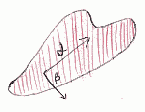

Hi all,
Given a contour (i.e. x-y points around the boundary of a shape), does anyone know how to calculate the eccentricity or even the ratio of eigenvalues of the covariance matrix of the points within the shape? The latter is simple to work out by filling the contour, but is there a method that only operates on the contour?
An example shape and eigenvalue-scaled eigenvectors α & β is shown in the attached image.
Thanks!
Doug

I don't really know what curvature is, but I don't believe it's what I'm after. I'm after a metric that describes the eccentricity of a shape.
I attempted to utilise the moments in (https://citeseerx.ist.psu.edu/viewdoc/download?doi=10.1.1.29.8765&rep=rep1&type=pdf) as I can see that the centred moments in equations (7),(8),(9) are simply the covariance of the shape. I previously used the covariance matrix of the pixels in the shape to get the eigenvectors. Doing the same (but for the contour) based on the above doc gives me a completely different result - it may be due to the difference between the shape and its contour (which has been interpolated to an approximation).
The code based on that doc is here and I've probably made a mistake in it, though I wouldn't ask you to spend time reading through it.

There were a few errors in the code, namely multiplications instead of additions in the two sumCentroidX/Y += ... lines, and a sumCentroidX instead of sumCentroidY in the iyy = ... line. Works fine now, phew!
