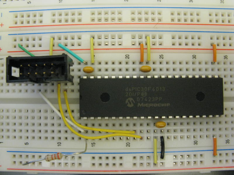

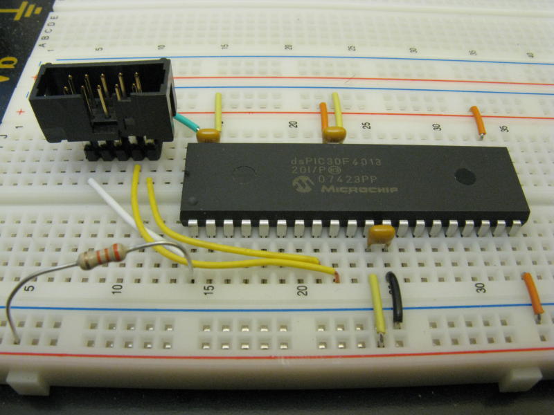

Got a dsPIC30F4013 today and breadboarded it up to play, but all I get from MPLAB is
ICDWarn0020: Invalid target device id (expected=0x141, read=0x0)
I've read all the dsPIC threads here, saying that they're a bit picky and took all the advice in those threads. Still nothing. :(
Could you guys have a look at these pictures and see if you can spot anything wrong?
As you can see, I even went so far as to build a new ultra-short programming cable just for this chip.
Have you selected the correct device in MPLAB so it downloads the new firmware?
Have you also provided the analog power pins (it looks like you did but I can't be sure). And try pushing the dsPIC into the breadboard harder. HARD. I spent 30 hours in the university lab "debugging" this problem.
Just clutching at straws, are you sure that the power rails are continuous, most I have used have a gap half way along. Have you tried metering from the ICD board to the Pic pins.
Unless this is a very old and well used breadboard I would be very surprised if it was a bad connection.
Yes.
I've double and triple checked that. Went over all the connected pins with a meter to verify that they're electrically connected to the board and wires. Even pulled the chip to make sure I didn't fold a pin under when I inserted it. All fine.
I can "Hold in Reset" and "Release from Reset" in MPLAB and with a meter on the MCLR/VPP pin, it responds as expected.
Hmm... Wonder if I got a bum chip? That would be a first.
I've never had one of those "gapped power rail" boards. All of mine are continuous.
I just finished going over the whole thing with a meter. All connections seem good.
Brand new, almost. Old enough to be tested a bit and found to be good. :D

Maybe Banana was referring to the extra EMUD & EMUC pins? It's a long shot, but try some pulldown resistors on those extra debugging pins.
I have a dsPIC30F3013 works fine on either the Junebug or Inchworm+, the breadboard has a lot of capacitance so you have to keep the PGC & PGD connections very short.
The two purple wires are very short.
Woops, it DOES have those pins. I was thinking it didn't.
Pulldowns on EMUD/EMUC pins tested. No change.
I rewired so PGD/PGC (and VPP) are as short as it is possible to make them. No change. :p
