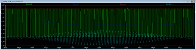

Thanks, this now compiles. I have not played with .tran in LTspice although i have done it in other spice versions. It is news to me that you can do a transient sim of a 4046 PLL at all, so I will have learned something new and useful if that is the case ;)
However there is still an error I had to mod your X1 because I think your LM339 model has changed. What I had originally was
I was not sure if I should switch + and -, but for now it seems to give a trace on dsout
What I can't get is a useful demod. I switched from the gaussian noise to the sinewave because it's the devil's own job to tell the original noise signal from the demod o/p where the unlocked carrier is rolling through. It is much more obvious on the sinewave baseband signal to me.
Although demod is fine without the control loop working (I don't know where Vmute should be) that's only if you set F_mid to 910k, in a simulation that will be exactly the right frequency of course. I tried setting it to F_mid = 911k just to give it a little bit of offset which should easily be within the capture range of the PLL, and the input signal to sine,
and the signal recovery isn't right. But perhaps I have butchered your simulation trying to correct the LM339 error. If I set the VCO back to your 910k then it is all dandy, but the VCO has no work to do in the ideal world of simulation
so I am not so sure how it would work IRL from the simulation

Yes, I even tested for 500 Hz sinewave, the audio output was 1000 Hz instead (see below)

I re-run the simulation of the new schematic, it gave the same result but with a clean stable feedback, V(vco_in).
So, I guess more revisions of the schematic are needed (mainly the model of CD4046) since there is no clear reason why a difference of about 1/1000 lets the demodulator become a frequency doubler!
