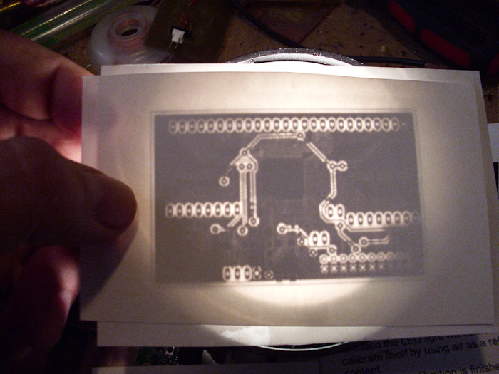

I wanted to try double sided PCB using toner transfer method. I printed out the top and bottom copper. My question is how to align the printed top and bottom on the PCB sides so that via holes and others are aligned? any tricks and tips?

I drill a few vias through a printout and the blank board, I use a pin to punch the same holes in the top and bottom toner prints, I use thin wire or fishing line to align them to the blank drilled brd, then tape before I heat-press them.

Just skipped through the video, but I think he is doing it like I used to do it. Just print out the two images, line them up using a bright light shining through and then tape the paper together so it doesn't move. Slip the PCB between and iron, everything should be lined up. Took a series of images a few years ago that someone was going to make into a tutorial, but it never happened.
I found using stick pins on the corners works well then tape together before laminating
or better yet laminate one side, stick the pins in the holes you drilled for alignment.
line up side 2 and use the pins for alignment. this method works even better.

For double sided boards with thru hole parts: Place a TTF print face up on the board and align to take strips of painter's tape along the 5mm border. Secure with bits of tape on the sides. Now use a large safety pin or the pin cap from a Krazy Glue tube, carefully press a pinpoint punch mark in the centre of any thru hole pads near the corners of the layout so the copper clad is marked. I usually add custom pad/vias just for this purpose, perimeter machine screw locations are good as well. Once you have 3 or 4 corners marked, carefully remove the TTF print and use a regular 'bobby' pin to pass thru each punched hole in the TTF. Now take the other TTF layer print and carefully punch thru the SAME pads with the bobby pin. I use a bit of backing cardboard to do this easily. It is important to punch the centres of all the pads you choose. Using a 0.8mm drill, carefully drill the registration punch marks you made on the copper clad.
If you're designing double sided boards you'll want to have a few holes somewhere that you can use to align both sides. I usually add an extra centimeter around the edge and put a small hole in each corner. The most important thing is to fill in all blank areas black it will make easier to iron and harder to rip/crease while sticking to the board.
I've only done the UV exposure method double sided. I used 4 thumbtacks, one in each corner, to align the masks.

I just tape my transparencies together on the ends after aligning them. Then slip the board between the sleeve. I use window glass to press everything together. I prefer to have the pigment side of the transparency next to the PCB and I have recently switched back to an ink jet printer for those. Water might cause smearing.
