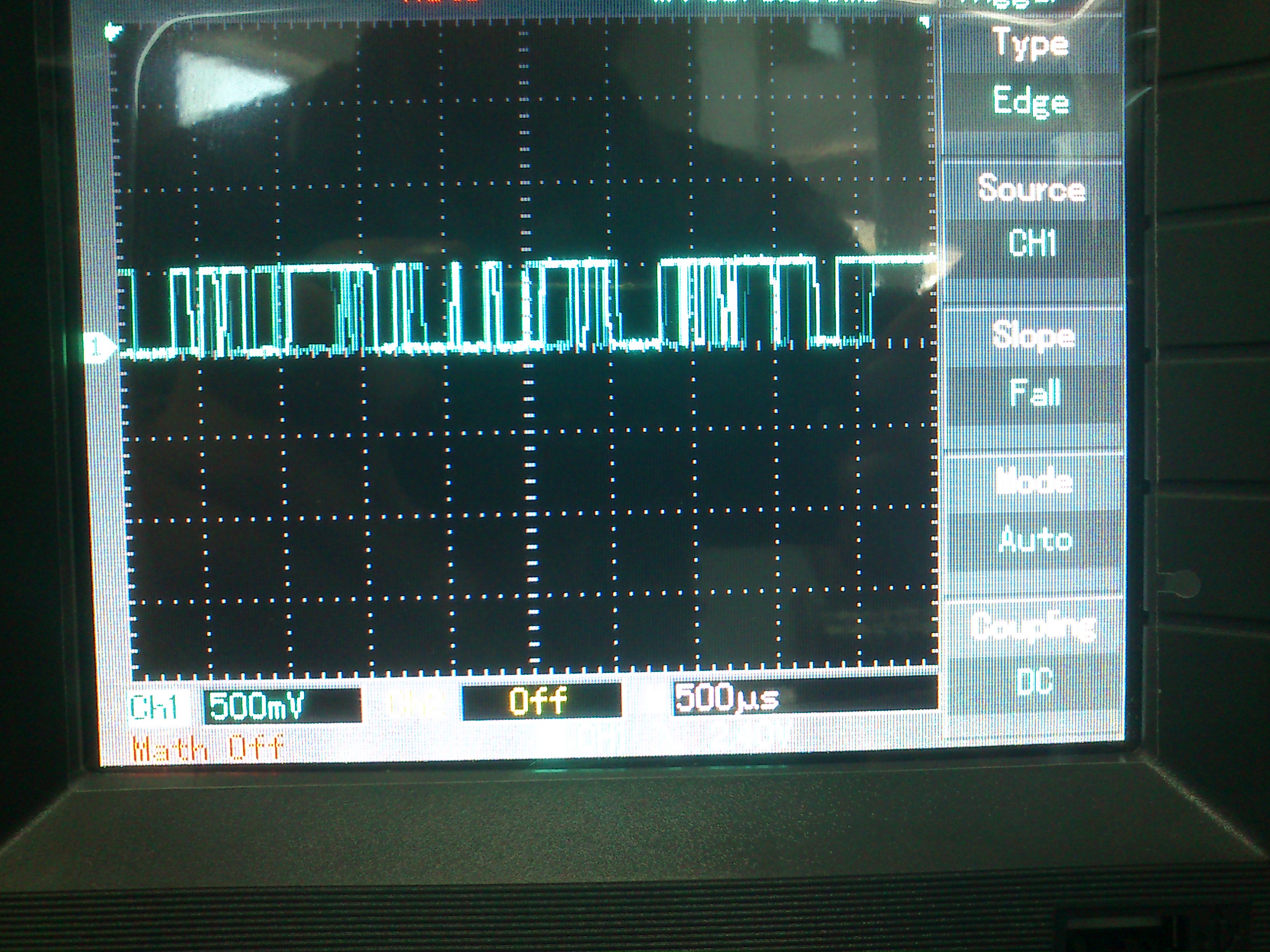

Hil all, i have a problem with Dorji Rf Receiver. My transmitter sends data in 53 second period but i cant receive them. I am taking rubbish signals. When i connect data pin to scope. I am seeing a screen like that
In addition. I cant see any data at logic analyzer.

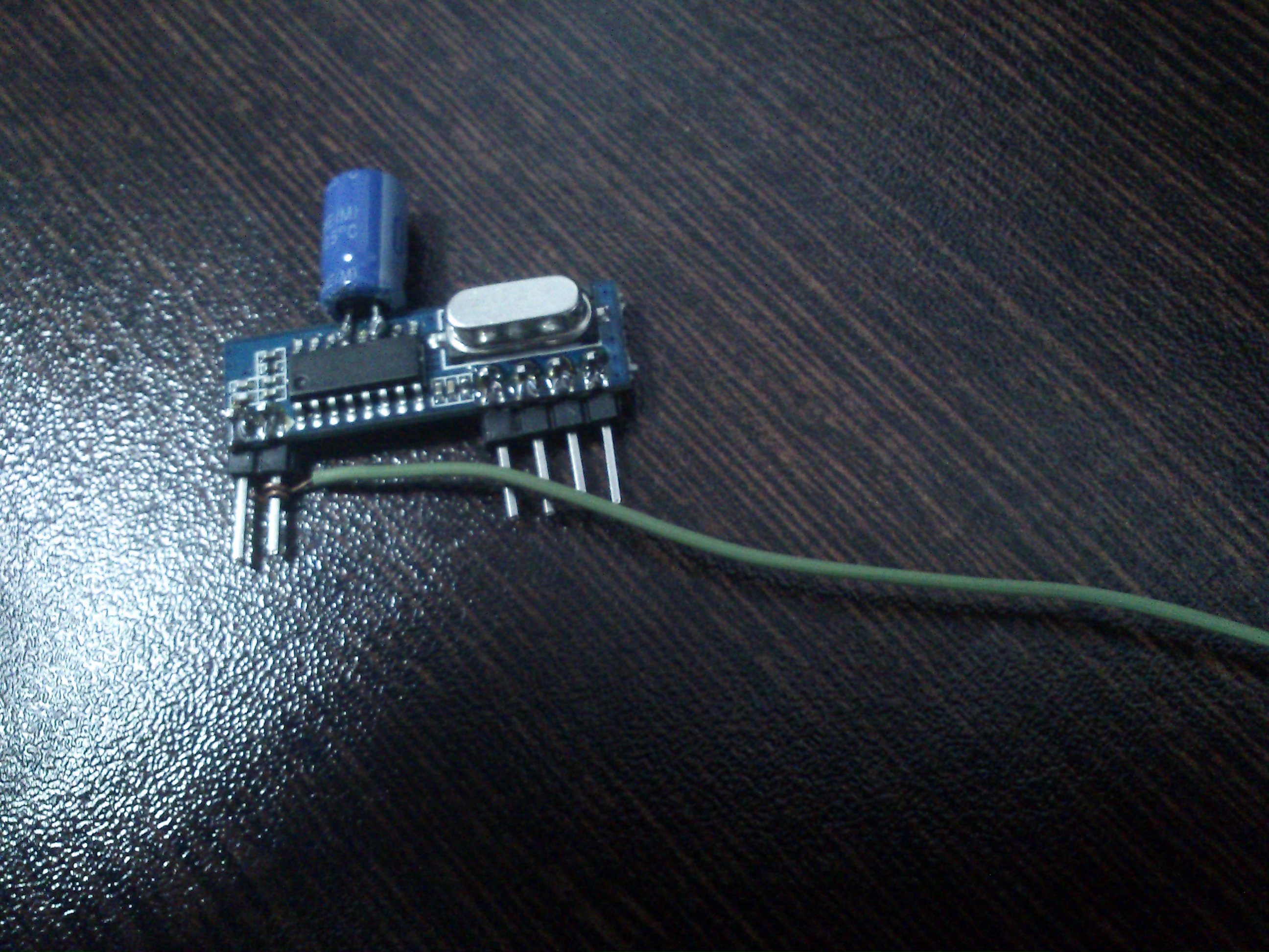

It may not be the root cause of your RX noise problem, but an un-tinned piece of copper wire wrapped around the RX antenna pin is not a good idea.
Your scope shows a 500mV signal, are you using a x10 divider probe?
Otherwise something is very wrong.

By the way, what is the gash piece of wire wrapped around one of the module pins?
Yes i use

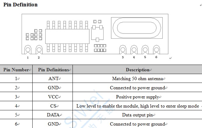

Rather than a picture of a standard module, a datasheet would have been better and some schematic of your connections to the transmitter and receiver modules.
Okey, It is datasheet of receiver;
https://www.wiltronics.com.au/datasheets/DORJI/RF-DRA886RX.pdf
It is 17,4 cm antenna.
https://www.electro-tech-online.com/custompdfs/2013/07/RF-DRA886RX-1.pdf

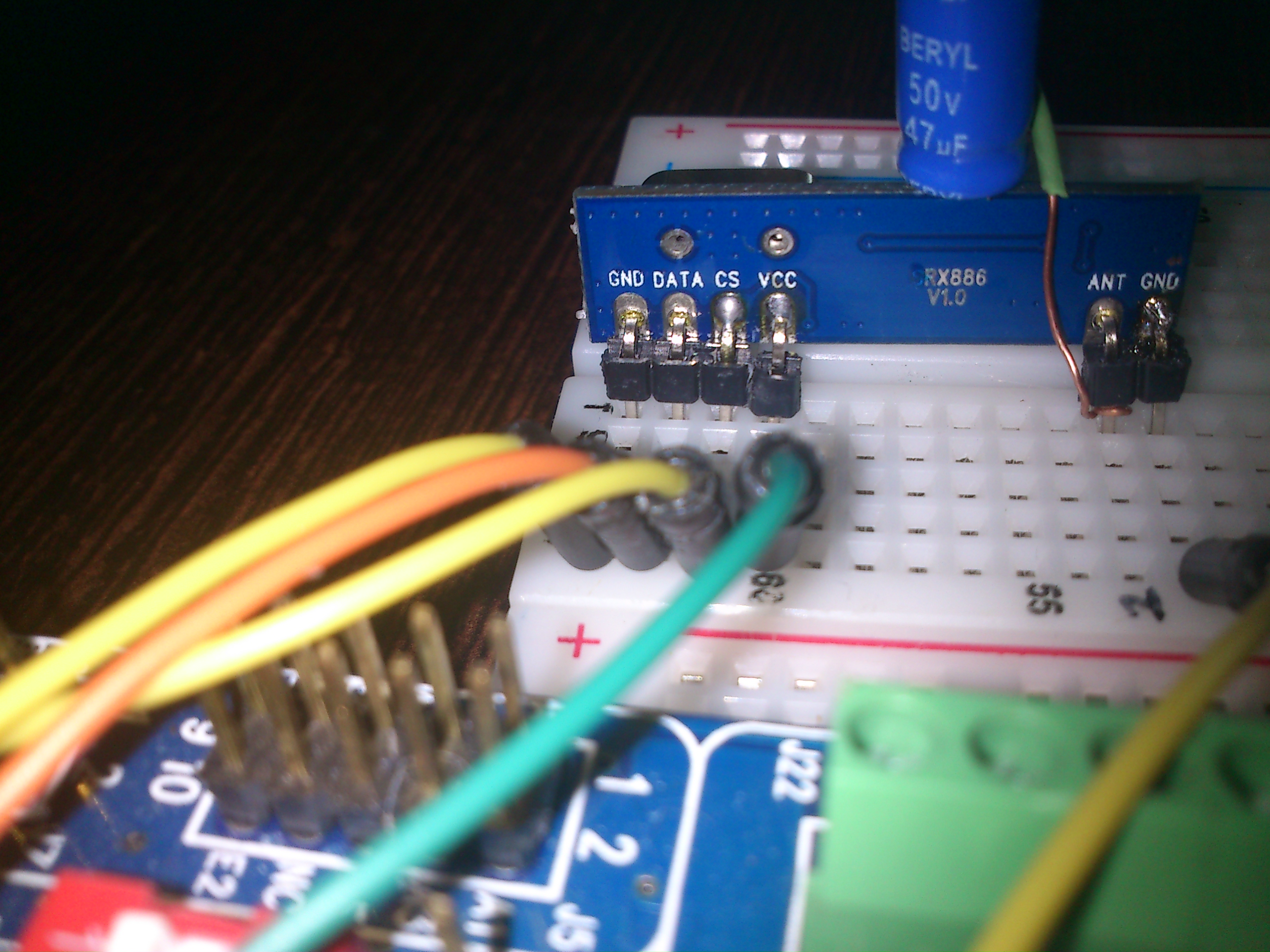

no, that's not what JimB meant, you just did the same thing
show us YOUR construction so we can look for wiring errors etc, your receiver board isn't going to work without power connections etc
lets see it all
Dave
It is my construction. Yellow cables go to ground, green one goes to 5V, and orange cable is data cable. I connect it to PIC or Scope . All of them directly connected. There is no extra thing. That capacitor(47 uF), i soldered it as external to prevent AGC by looking IC's(SYN470R) datasheet which inside my receiver module.
