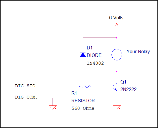

i've been working on a project but now im stumped and seemed to have hit a brick wall, i need to send a starting signal to a circuit by activating a 6Vcc relay, but i need to send that signal from the computer, i think i need to convert the digital signal to analog, but then again im not sure how to conect something like a DAC00800 which i can get quite easily but i've seen the tech sheets and i cant understand a thing. And second of all what would i connect to it? the Serial port from my computer comes into mind, but im not sure if its possible or what would i need.

Just a few things real quick. The relay you want to control? I saw a mention of 6Vcc so I can assume this is a 6 volt DC coil relay? If that is true we need to know the relay coil current? The data sheet for the relay would be a big help.

Ehmm i hate it that i cant post links without it taking ages to get approved, the relay is a Sun Hold electronics RAS - 0610
NOMINAL VOLTAGE (VDC)
6V
COIL RESISTANCE () (+/- 10%)
100 Ω
POWER CONSUMPTION (W)
0.36W
NOMINAL CURRENT (mA) (+/- 10%)
60 mA
PULL IN VOLTAGE (VDC)
75 % MAX.
DROP OUT VOLTAGE (VDC)
10 % MIN.
MAX. ALLOWABLE VOLTAGE (VDC)
130 %
Also Im not using the default software to measure, im calling the Universal Library from a C++ Program so in theory i could call the Digital out procedure from the same proggie in the moment i need it. (i suck at Electronics, but im ok in proggraming :D
OK, great! In theory your DO port will sink something like 150 mA @ 5V but all you need to really do it right is a simple transistor to drive your relay. Attached is a circuit using a 2N2222 transistor, very common. The diode across the relay coil (observe polarity) is there to snub the inductive kick when the relay field coil collapses.
Another way to go about this would be to use an opto-coupler but the attached should work fine.

Wonderful! now, i have some questions, that would be connected directly to a digital output in the DAQ or would i need another setup before this diagram?
Second The Digital Com. What does that stand for? the Digital Ground from the DAQ? The Arrow to F is Analog Ground?
Also by checking online i can quickly locate a 2n2222A Transistor and a 1n4004 Diode, will they work? should i look arround for those exact part numbers?
On the DAQ output digital comm is digital ground. Different manufacturers use slightly different terms. You would connect exactly as drawn and that is it. Not much to it. The transistor base resistor connects right directly to the DAQ output port and common in my little circuit is digital ground. Yes, the arrow to F is ground or common. The top of the relay coil connects to your 6 volt relay power.
The 2N2222A is just fine as is the 1N4004. The transistor can handle up to about 200 mA so driving your 60 mA coil should be easy and not require a heat sink for the transistor. It is just a simple switching circuit. We drive the transistor into saturation so it acts like a switch. This way we don't place the burden on the DAQ output.
