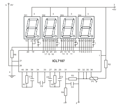

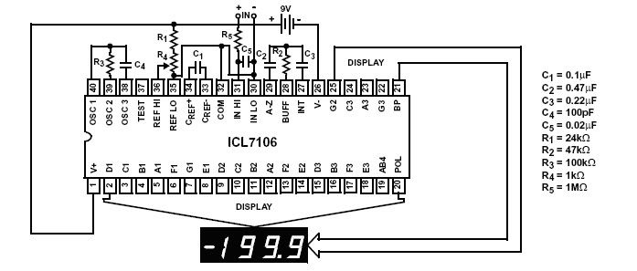

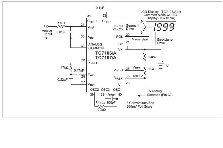

I have read all old threads about voltmeters and I feel bad to bother you people with this Sorry.
I am not that expert in electronic like you guys, but I have to do something for my scool project, and I decided digital voltmeter (there are many reasons).
So I have seen schematics on the electronic labs and on the microchip for the TC7107 ( I belive thats the same like ICL7107). I dont like that one from the el.labs because I want to have a battery (maybe 9v). And I dont get something on the tc7107 scheme (someone said it is a voltmeter scheme on the page 3).
If I dont want to have lcd display, I want 4 led displays(7 segm), how should I connect it with the icl7107??
On 7107 it says 2-19, 22-25 (pin) and segmet drive to the left of the lcd, and pin 20 on the minus sign and 21 on the backplane drive. And again I am asking, how to connect the 4 led displays ?? And if I choose lcd anyway, where is that minus sign, backplane , segment??? I have one lcd and I dont kow what to conect with what?
And one more question , do I need to write a program on computer for so this one can work, or I dont have to??
Thank you very much. I know I am a newbie , but I am confused, and my teacher know less than I do, so I need help to get an A to finish my school. Well, I have time until 5th month, Please help .
https://i137.photobucket.com/albums/q220/zeeq1/ellab.gif
https://i137.photobucket.com/albums/q220/zeeq1/7107.jpg
