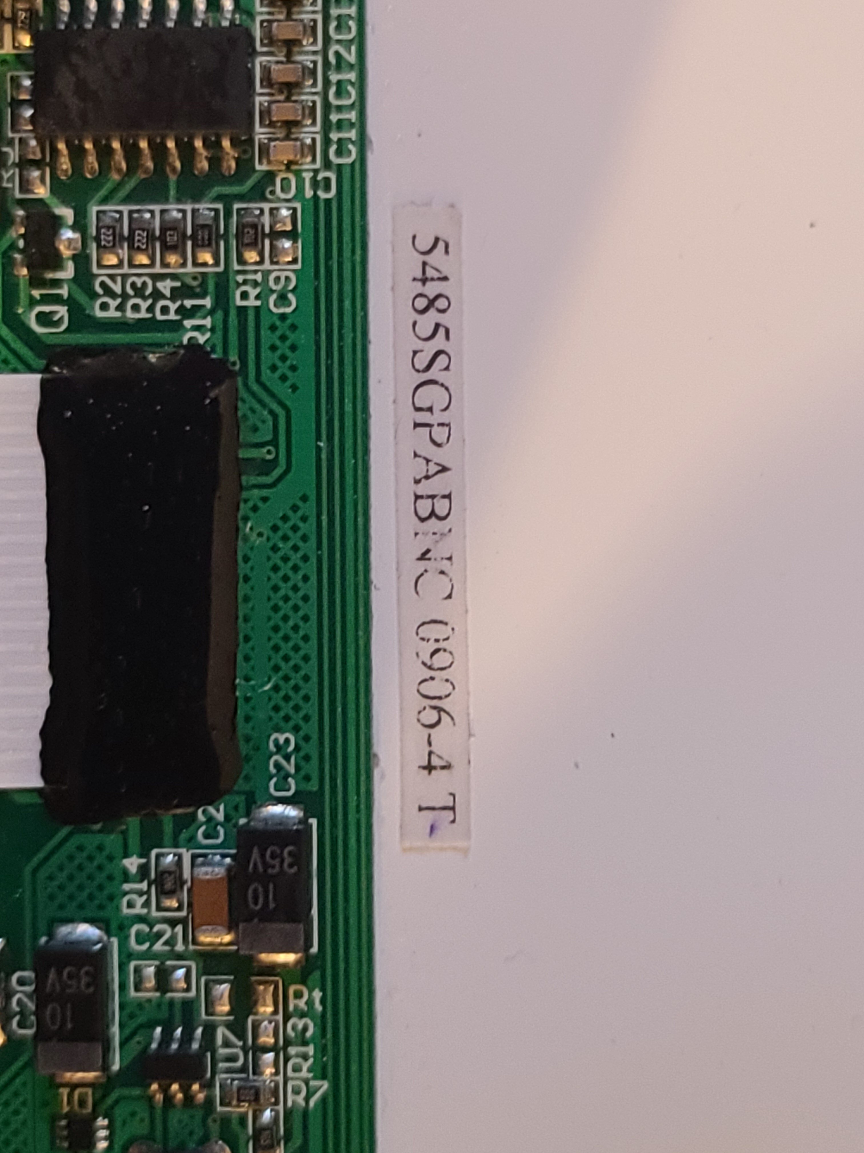

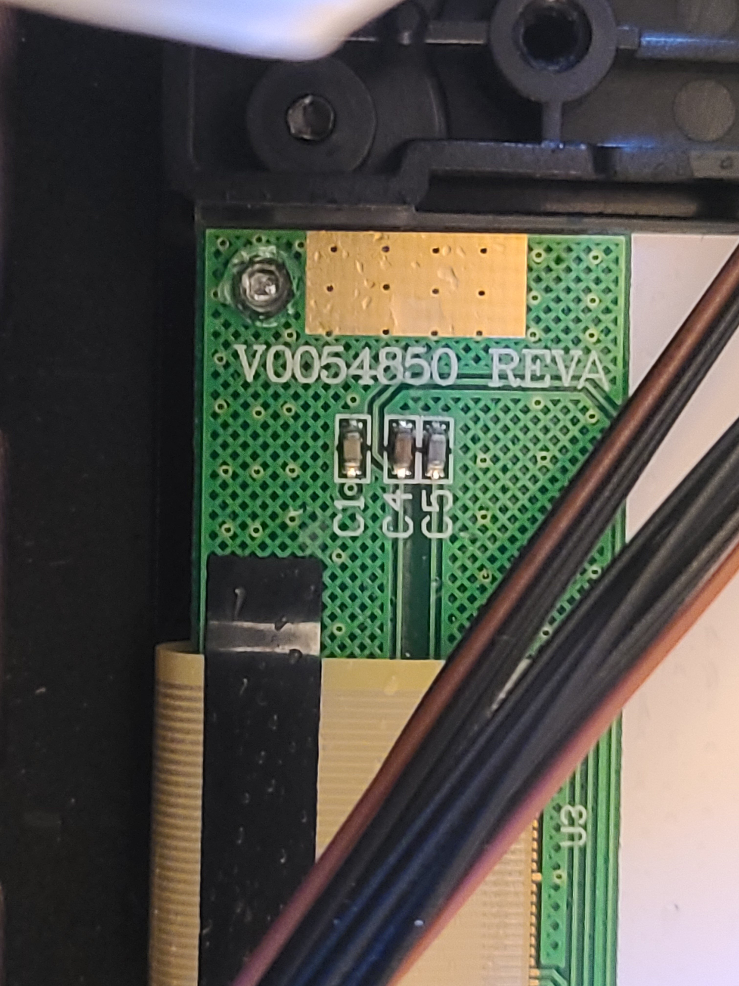

The information on the back of the Juno G display is as follows;
5485SGPABNC 0906-4T
V0054850 Rev A

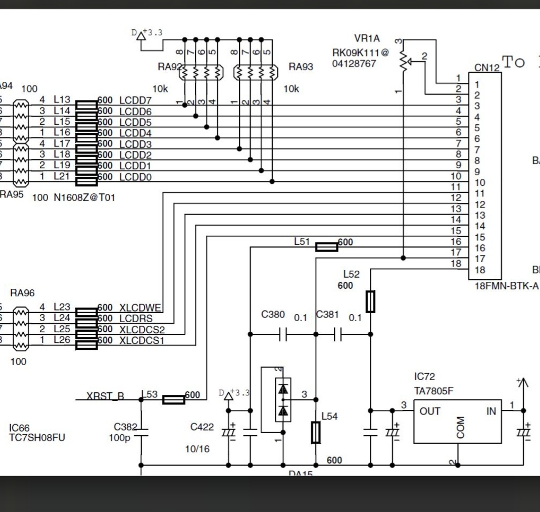

Please also see the included diagram info from Roland.

The connection to the screen is an 8 bit microprocessor data bus; the screen is effectively a computer peripheral and the "video" pixel information is created by the display controller IC within the LCD assembly.
It's an odd size display and there is no fixed standard I can find for the addressing or chip select lines - there are some displays with the right pixel format but connecting one up and getting it working will involve some serious trial and error.
or these:
The power, ground and data bus lines D0-D7 should be straightforward, also the register select (RS) and write enable (WE).
The chip select lines are the tricky part - there are just two from the synth, but apparently four used in the LCD. It may need a 2:4 decoder IC & some other bits of logic adding and that may relate to the different firmware updates required for different generations of Roland replacements?
There is a post half way down this page with a download link for the 2.01 firmware:

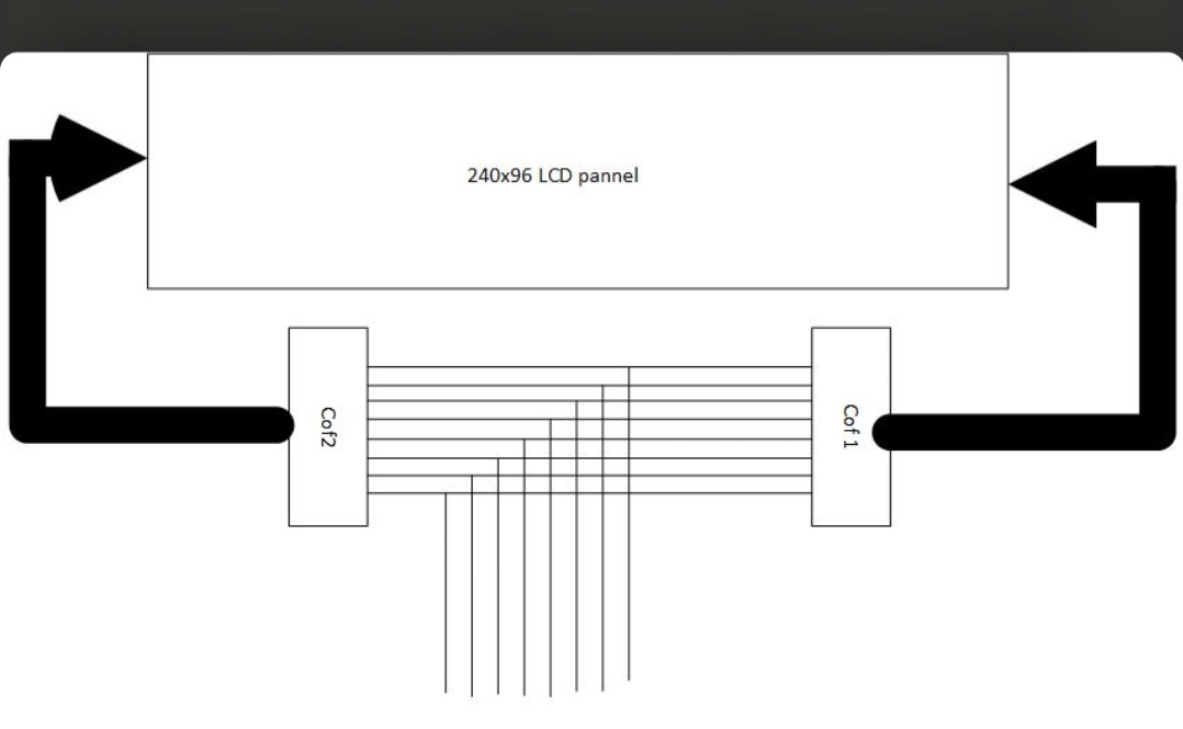

Note that several people have found the display fault to just be bad connections on the various plug-in interconnect cables and fixed it by treating everything with switch cleaner.
Another one here relating to the fixed ribbon cables on the back of the screen:

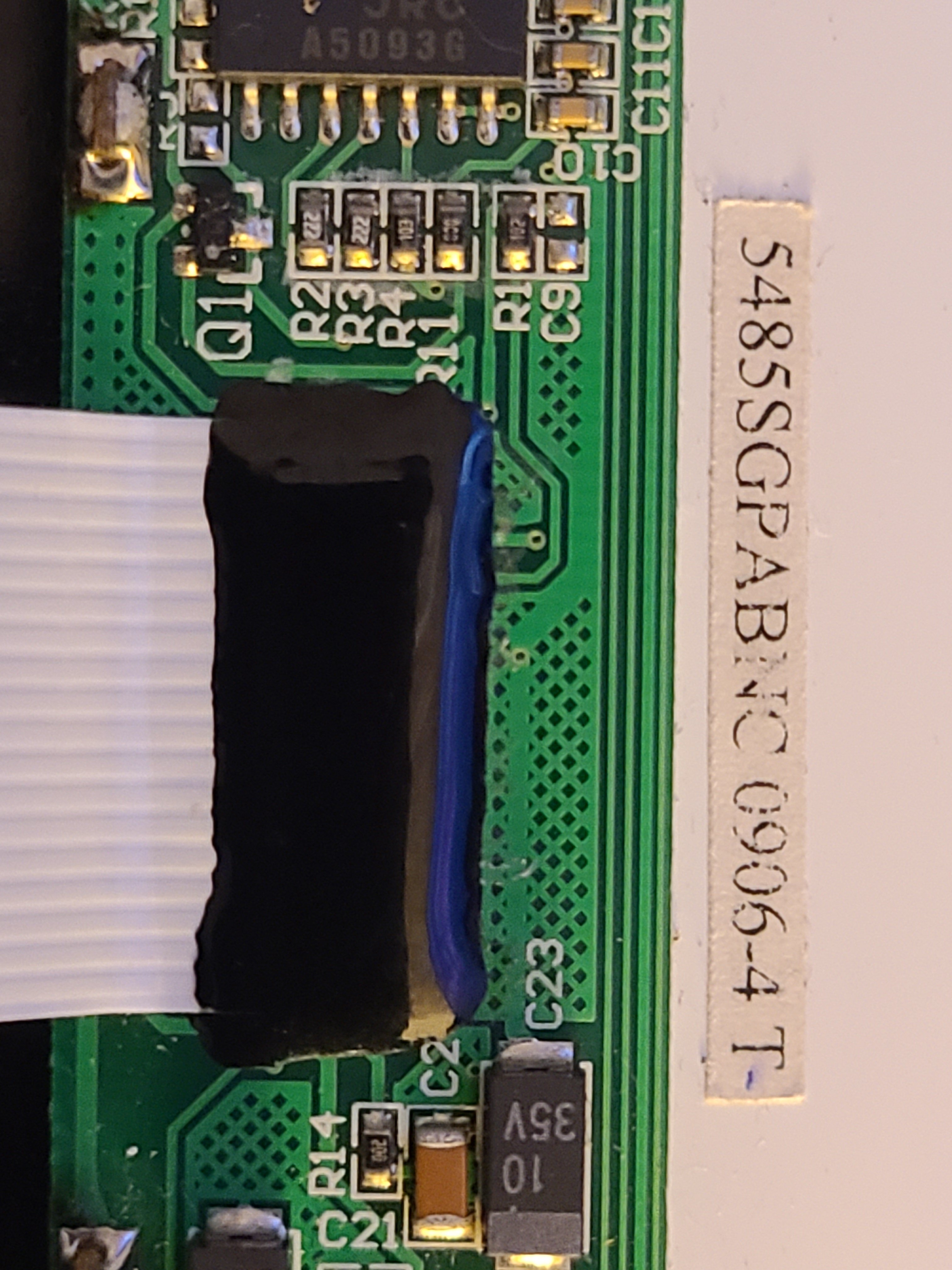

I had a similar display problem. My Juno-G was already once fixed and the display was replaced, and after a year the new display broke again same way as before. I opened it and noticed that it has something to do with the two ribbon cables that are not getting contact in the display unit. I warmed the ribbons gently with a soldering iron from points where they are connected to the display’s component side board. This helped for now.
At least now it has worked for some time. I guess they make some mistake in manufacturing process when attaching those cables as so many similar cases have appeared.

    I’ve done it in the same way, and used desoldering-wire between the strip and the soldering-tip. My temparature was about 310°C for best results. It’s done in aprox 30 minutes.
Thank you so much for that detailed information! I've had the entire unit apart and cleaned all ribbon contacts woth no success, but the trick about heating the connections on the back of the lcd was not something I've tried yet! I'm excited to give that a go and with any luck I'll be able to avoid a major headache. Thank you again for your help!
Hello, I've removed the LCD screen and heated the two side ribbons as specified in the post above. When I turn on the unit I still have LCD issues but I've been able to isolate the issue to the ribbon in the center. Unfortunately it seems to be covered in epoxy and I'm just wondering how to go about reflowing that area?
Thanks in advance!
