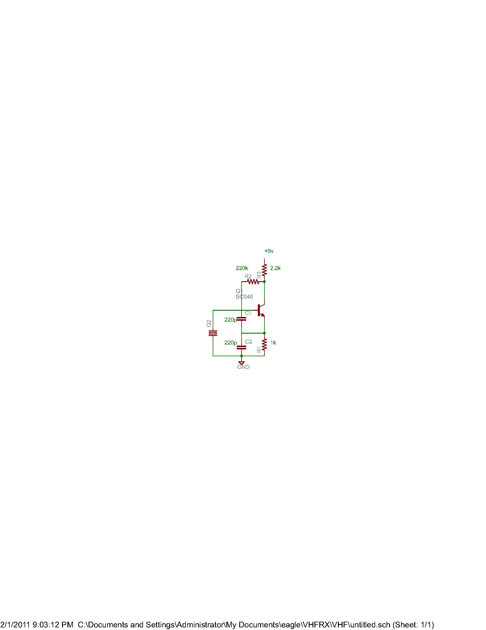

Alright so I'm trying to make sense of a Colpitts Oscillator... and nothing is working :(
Here is what I have.
Now that MPS2222 transistor is runnin 200HFE, and that 25mhz crystal requires 18pF load capacitance...

I'm afraid the circuit you have there is nowhere near correct. For a start, there is no DC path to the transistor base, so no base bias current is available. Q1 collector and emitter are connected directly to the battery with no intervening impedance, so the transistor cannot deliver any useful output...
The best thing for you to do would be to find an example of a properly designed oscillator, perhaps from a textbook or a web search.
When you have got that, there might also be some issues to deal with in getting an oscillator simulation to start, but first let's get the circuit right.

There is something odd here: with no oscillation and the resistor values shown, the base should be about 2.2V, the emitter should be at about 1.6V.
Best to get the DCs right first.
Once you have a reasonable collector current, which looks as if it should be a bit over 1mA, for the values you have, the next step is to give the circuit a nudge to try to start it. In the real world noise voltages should do this, but a simulation may need an actual kick.
I suppose that you are doing a Transient analysis using something like PSpice. You could try putting a pure current source in parallel with the crystal, and applying a small pulse, say 1mA high for a pulse length of half the crystal period (33ns for a 15MHz crystal).
Oops - nanoseconds, not milliseconds!
Break the connection between C1 and Q1 base. Make sure Q1 base is still biased. Verify Q1 bias as shown above. Then, connect a signal generator to Q1 base, and measure the voltage at C1, where you broke the connection. If the voltage at C1 is a little higher than the signal generator voltage, then you should get oscillation. I am guessing it won't be, and you'll have to make C1 smaller.

Try this
See if this will work for you
