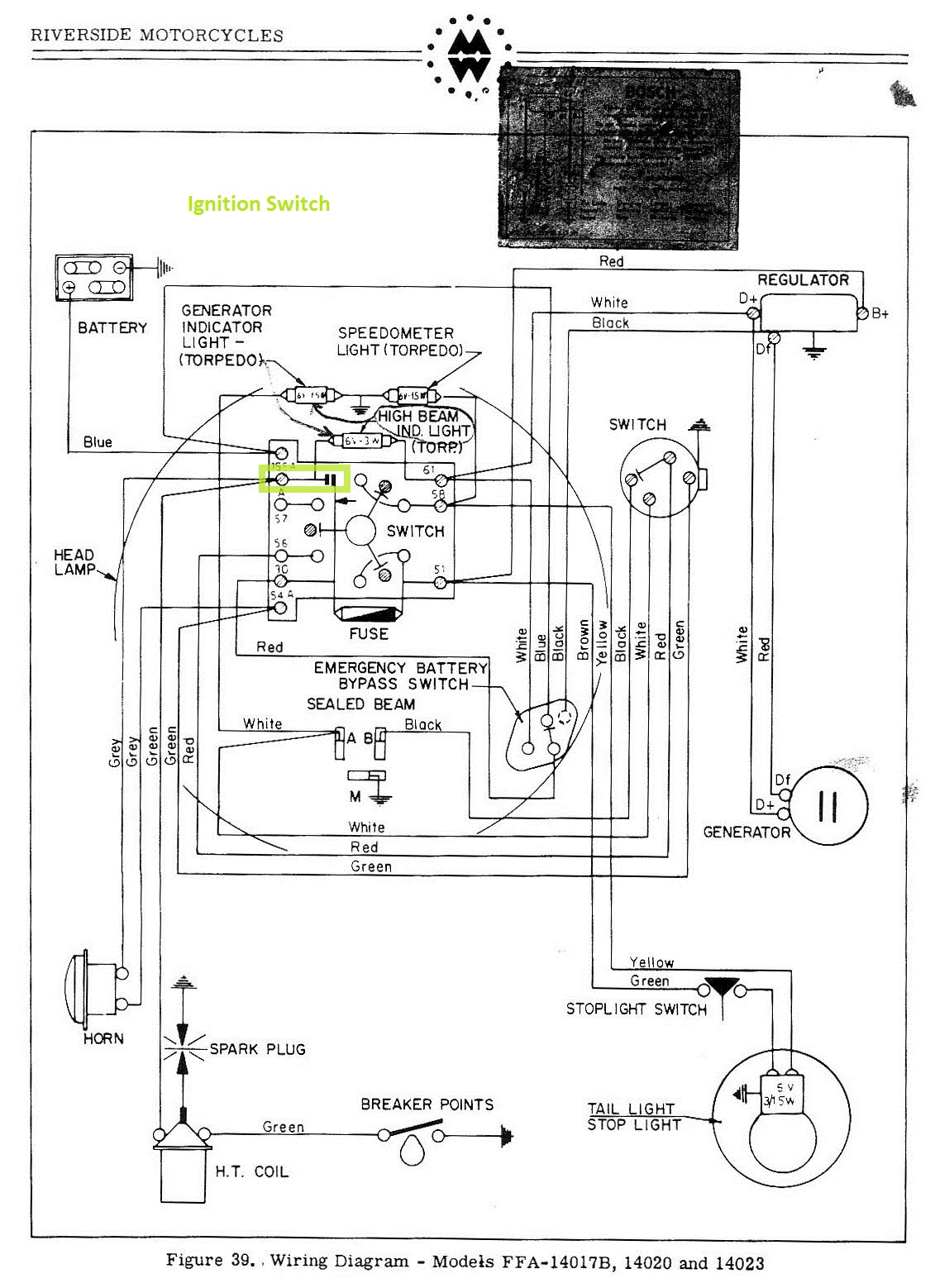

I added a Velleman transistor assisted ignition kit to a 1965 Benelli/Wards Riverside motorcycle ignition circuit. But with the added ignition kit, the connectors for the coil+horn on the circuit board heat up and start to smoke! And there's no spark at the plug.
The motorcycle circuit is a little strange, in that the coil+horn looks like there's a direct connection to the battery, bypassing the main fuse! Why would they do that?
What could possibly be going on to cause the hot junction ? Attached is the Velleman manual, highlighted on page 7 where it talks about ballast resistor. Should I add one?
Also attached is the motorcycle wire diagram, highlighted to show the ignition switch, which connects as soon as the key is inserted.

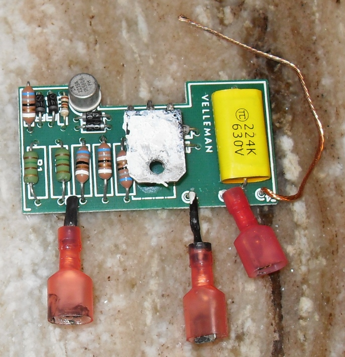

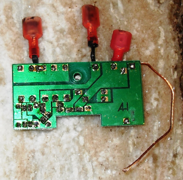

If you have connected the unit up as shown in the diagram in the manual then the current into pin 1 should be no more thatn about 300 mA with the contact breaker in the closed position and even if T1 had a collector emitter short. Show us a schematic of how YOU HAVE WIRED the unit and also a picture of both sides of the board so we can see if you have shorted any tracks out with bad soldering. With the board NOT connected measure the resistance between pin 1 and pin 2 and also between pin 1 and pin 4.

Attached are pics of the unit, without the heat sink.
Also attached is a diagram of the kit connections to the bike. The only difference I made, was connecting the lead from 1 directly to the coil (+). Since it's closer than the ignition switch, and the ig switch should be just a wire going straight to coil (+).

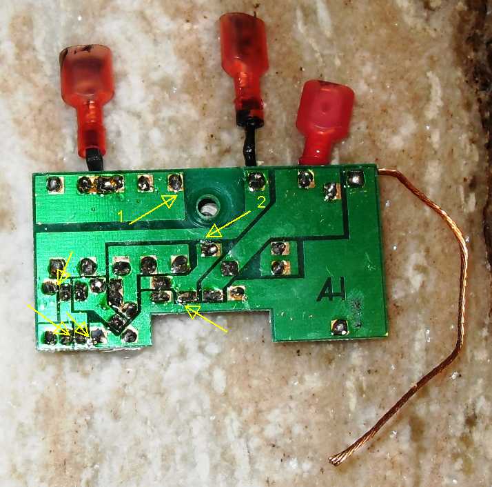

From this image, marks seem to show there was a washer over the mounting hole. If metallic, it could have shorted to track areas 1 or 2.
Check for solder splashes at the heads of arrow 2 and the non-numbered arrows.
Hi Alec,
Well spotted. I had not noticed the mark from a large washer. That would explain the large current if the transistor mounting screw was also being used to bolt the board to ground but it would not explain the zero ohm reading between pins 1 and 4 with the connections removed. I could see no solder splashes that would explain this short. (I am starting to think that when Jo said "no resistance" he means infinite resisance rather than zero resistance.)

I don't have much faith in that Riverside wiring diagram (if I'm interpreting it correctly). The only supply to the ign coil primary seems to be via the horn button or via the generator indicator bulb ??
Those two 'plates' inside the yellow/green rectangle.... I think that is a mechanical switch that is open when the main switch is 'off' and closed when the main switch is 'on'. That would get power from the regulator B+ through the fuse, or from the battery via (looks like) '30' on the switch.
Good eyes. The circular marks are from a nylon screw that goes through the unit, holding the transistor to the metal container lid, that I'm using as a heat sink. There's a mica film shielding the transistor from the lid. I'll try the unit again, without the metal container, in case the container is shorting the unit.

Thanks for pointing out the solder splashes. Most of them are actually marks in the board's resin surface and not solder. I verified w a multimeter that there's no continuity between the "arrowed" pins.
Alec, the bike's diagram is hard to read. I high-lighted the ignition switch in yellow, which is closed as soon as the key is inserted. It's easier to view the coil's power path by following backwards from the battery. Oddly, the coil and horn get power directly from the battery, bypassing the main fuse. Without the transistor unit, there's no problem. But adding the transistor unit, and the coil+horn get too much power and heat up almost to smoke, before I pull the switch.
Is it possible that the transistor unit is giving the coil+horn a new ground, that allows the current to run?
P.S. The only error I've found in the bike's wire diagram (and it's not relevant (I think)) is the black wire from the Emergency Bypass Switch to the Regulator Df point. That's incorrect, it actually goes to the Regulator ground. The Emer. Bypass allows the bike to be started w a dead battery, by removing the battery and connecting the coil to the generator. You push start the bike then.
Ylli, thanks for pointing that out. I didn't notice that before. It does show that the coil is connected to the generator (and ultimately the battery) at a second point, but the power then has to pass through the hi-beam indicator light. I don't understand why. If it helps, when the transistor unit is on the bike and powered up, this high beam light glows mildly.

After testing, it appears that the issue is the unit grounding out against the metal enclosure I put it in.
This isn't complicated, so I think I can properly isolate it.
