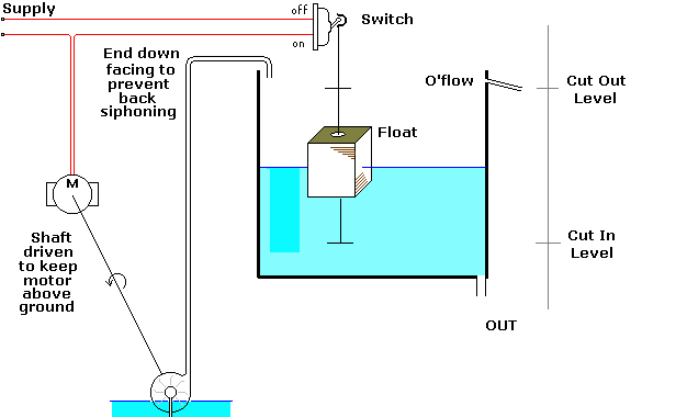

A simple way would be a timer - say 10 hours.
This is not really intended to be a practical arrangement, although
something similar probably could be practical.
It sort of popped into my mind when i saw the comments on simplicity
and complications.
I put it forward as a contender for the kiss prize.
Any takers ? ........... John :)

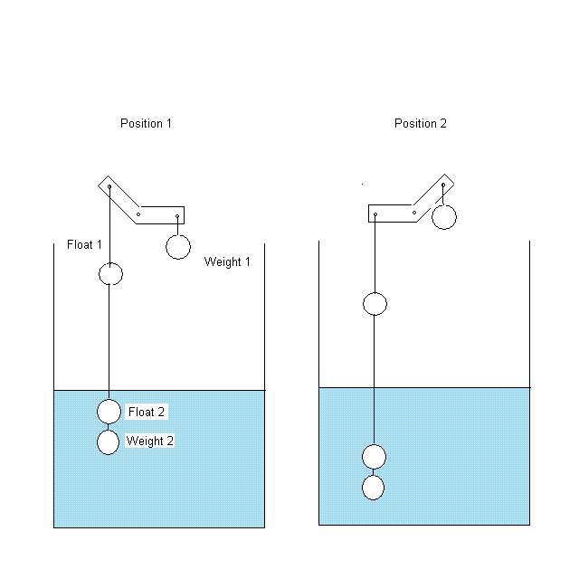

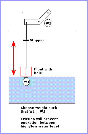

An idea. The weight 1 on the right is equal to the weight on the left with weight 2 and float 2 submerged.

A modified version of that by FRIED. But now it looks the same as that by John1.

The idea does not rely on friction. It relies on mechanical advantage.
If, ignoring the weight of the floats, weight 2 is 500g submerged and the displacement of the floats are 300g then the submerged weight and float on the left side is 200g, and weight 1 is 200g. In position 1 weight 1 has full mechanical advantage and the other side has (45°) 1/√2 advantage = 141g, so is stable. (Relative moments) The same reasoning applies to position 2. Using a single float that slides will work as long as it weighs enough to tip the balance at low level, in this example more than 59g and has enough spare displacement above this at the high level to lift more than 59g.
Oh, not referring to your design. I meant my "float" version depends on friction to work so is definitely not a good one to use.

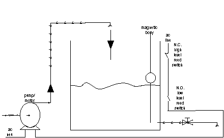

omega.com
I suggest going to the following: Omega.com and reviewing the good reference material and products available for level control. I use their products for temp,level,pressure,flow,and data aquisition at my job all the time. They have float assemblies that can be mounted in the tank with various combinations of N.O., N.C. switches that can be used to turn a pump on to fill the tank and shut it off when it is full. A relay doesn't even have to be used when using two switches. The length of they bouy's magnet can control cycling. Of course, Hysterysis and cycling could also be controlled using a time delay relay. There are several other alternatives including capacitance and conductivity sensors that can also work.

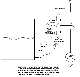

pressure switch
another way to control level is with a pressure switch. Mount the switch at the bottom of the tank and adjust diaghram spring tension to tank head pressure level. deadband is introduced by the mechanical spring.
