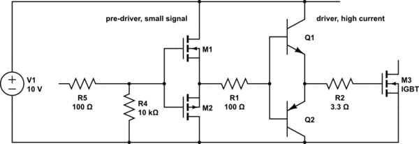

eg. something like the Q1 & Q2 part of this, added to the 555 output, to boost the current to the FET gate resistors:

OK, you can certainly "level shift", but you still need the high current driver stage between that and the FET gates, or you will just melt them.
That circuit would provide the correct voltage but next to no turn-off current, so the FETs will spend most of their time partly on & dissipating high power levels; the 555 could provide 200mA, that can provide some turn on current but only a fraction of a milliamp turn-off current.
See here for more information:
Look at something like these instead; they can take a logic level input and translate it to a suitable gate drive voltage with 1.5A output current. Each IC has two sections so can drive two FETs. That will give "clean" switching and minimal power loss in the FETs. Use a 6.8 Ohm resistor between each driver output and the FET gate it controls.
Or add that entire driver stage above (from R4 onwards, to R2 driving the FETs, with R4 being R10 in your circuit).

However, the small FET's could be replaced with one n-channel FET to ground, and a pull-up resistor. I've been comparing the NPN/PNP driver circuit with specialised IC drivers, and it seems to work just as well. With just the 555 driving the FET's (even worse with multiple FET's) you'll be wasting a lot of heat in those FET's.
As for his last suggestion, it's obviously a lot better getting rid of the 555 - but still no FET driver, and the FET's will get FAR hotter than they need to. Paralleling the FET's only makes it worse, as it multiplies the already high capacitance.
Here's the driver I'm using from PIC to buck/boost FET - PL2 and Q6 are simply an extra inverter, selectable via PL2 to invert or not - while PWM on most modern PIC's can be set positive or negative, it's best to have the default the correct way to stop killing the FET.
