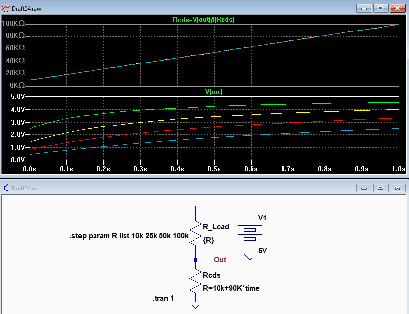

    I have not had the opportunity to employ as Cds in the manner, but it seems a correct usage or at least a popular one.
    The goal is to be able to differentiate bright sun, from clouds, from dark. The typical circuit is a CdS cell-resistor voltage divider connected to a ADC.
    If we take a given the Cds Cell in bright sun is 10K and darkness as 100K (just some numbers to work with). What resistor value should be used to achieve the highest range (given 0-5V)? A 10K resistor will be 0.45V to 2.5V. Is there more to be had without burning out the CdS cell?

    Here's an LTspice simulation for an Rcds variation of 10kΩ to 100k Ω and load resistors of 10kΩ, 25kΩ, 50k, and 100kΩ.
    Which looks best to you?
    You shouldn't have to worry about burning the CdS for a supply voltage of 5V as long as the load resistor is at least 1kΩ.

    My assumption (gut feeling) was correct. There isn't a simple way to expand the operating range of the simple CdS-Resistor combination to fill most of the 5V range. At 10K, it uses the lower half, at 100K the upper half, anything in between uses the in between. I can either gain the output with an opamp or raise the pullup voltage on the Cds-Resistor.

    Notice I said "most of the 5V range", not all or the full range. I don't think I could get all of it and with variation of the CdS cells probably lose some at the top and bottom anyway. So the target is most. As you notice with the 10k simulation, the range is 0.45V to 2.5V, 2-2.5V of the 5V range. I find it better to get as much as you can when you start. It's easier than realizing later you need more and having to redesign.

    Many (most?) ADCs require a source impedance of <10k to obtain reasonable accuracy, so you will probably need to buffer the voltage across the cell. If so, the buffer amp can have gain and offset to give a full 0V-5V input range to the ADC.

    From the simulation, I prefer to eat my sandwiches from the end not from the middle. From your simulation, likely the 10K as it appears to be more linear than the 100k (I haven't had time to do calculations yet to verify). I've received PMs stating a 10K would be the maximum and I should be looking in the 1k-10k range.

    Yes, the ADC wants a source impedance of <=10K. Yes, it is more convenient to use a resistive divider that has an output impedence of >10K. Solve the problem by shunting the ADC input to ground with a 0.1 uF capacitor, after all, the clouds do not move that fast...
    I have used this trick when sensing 12V battery voltage, where I wanted the two resistors in the divider to be high enough not to provide much leakage to the battery (>~100K). The capacitor holds the voltage at the tap constant while the AD does its dance ( a few tens of micro-sec ). The DC input leakage spec for the AD is ~1uA, which does not load the voltage divider much. Again, the battery voltage changes slooowly.
    Besides, you are supposed to use an "anti-aliasing" filter upstream of any ADC input...
