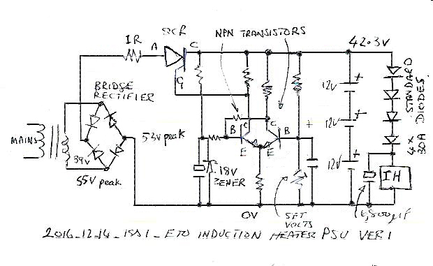

Below is a rough schematic that I knocked out in a few minutes. It is very much notional but it gives an idea of the sort of arrangement I have in mind. Although the circuit may look complicated it is not. Would you be happy building something like that?

spec, not meaning to hijack the tread, but have a question. The schematic in post #33, you show four diodes in series to drop voltage. I other threads I was going to do that in a circuit and was told it was a bad idea by a few people. Is it a good practice to do this? It was the only way I could/can figure out how to give a specific voltage drop in my circuit, that is stalled because of people saying it's not good practice. Thanks for an answer.
Hi SB,
I can quite understand your dilemma about using diodes to generate/drop a voltage, but to say that it is a bad idea full stop is too wider statement- it all depends on the application and the implementation.
Diode and BJT VBE drops are ubiquitous in electronics and are used in pretty much all integrated circuits, one way or another, with great success.
One of the things about using diode drops, that puts people off, is the temperature dependence of roughly -2mV deg C. Sometimes that voltage change with temperature is a nuisance and other times it is essential, for example in temperature sensors or VBE multipliers in typical class AB audio power amplifiers.
To put the voltage/temperature variation in perspective though:
(1) The forward voltage drop of a standard silicon diode, at relatively low currents, is around 600mV at a junction temperature of 25 Deg C. This is based on the 'band-gap' for a silicon semiconductor junction which is a physical characteristic.
(2) If you take an equipment local temperature as ranging from 10 Deg C to 50 Deg C, that gives a temperature change of 50-10= 40 Deg C.
(3) With a 40 Deg C temperature change the diode forward drop is going to change by 2 * 40 = 80mV
(4) So the total percentage voltage change is, (80mV/600mV) * 100 = 13.33% or +- 6.67%, which is not an umanageble voltage change.
Of course, all this is very simplified and is only a rough guide; as soon as you start taking significant current, compared to the diode size, the diodes resistance come into play and that resistance is temperature sensitive too.
In the circuit of post #33, the requirement is extremely loose: just make sure that the supply voltage to the induction heater never exceeds 40V and, ideally never drops below 36V so, in that application, the string of four diodes will do the job, especially as it is guaranteed that the induction heater will be taking around 30A, which should give a forward voltage of around 1V per diode.
It is not a pretty circuit though I must admit, and for a production item would not be used (the whole approach would be different), but it is cheap, flexible, and effective; that is the aim anyway.:)
I hope all that answers you question SB; if you would like to discuss the circuit where it was thought that using diode drops was not ideal, just post the circuit on a new a thread and we can all evaluate it- I bet there will be a wide range of views.:D

Hi again Ed,
About the four battery approach: you have got the opposite problem. That is not enough volts from the bridge rectifier to charge the four battery stack to the ideal charge voltage of 2.35V per cell (24 cells in a four battery stack = 56.4V total required).
But the real worry is that the top battery will be badly overcharged (in view of the current capability of the transformer) while the lower three batteries will be under charged.
Also, you would still need to limit the induction heater voltage to 40V, so a few diodes would again be required.
Sorry for the negative view.
As an aside, I have just realized that it would be wise to put a 50A or so fuse in series with the output of the bridge rectifier as a precaution.
