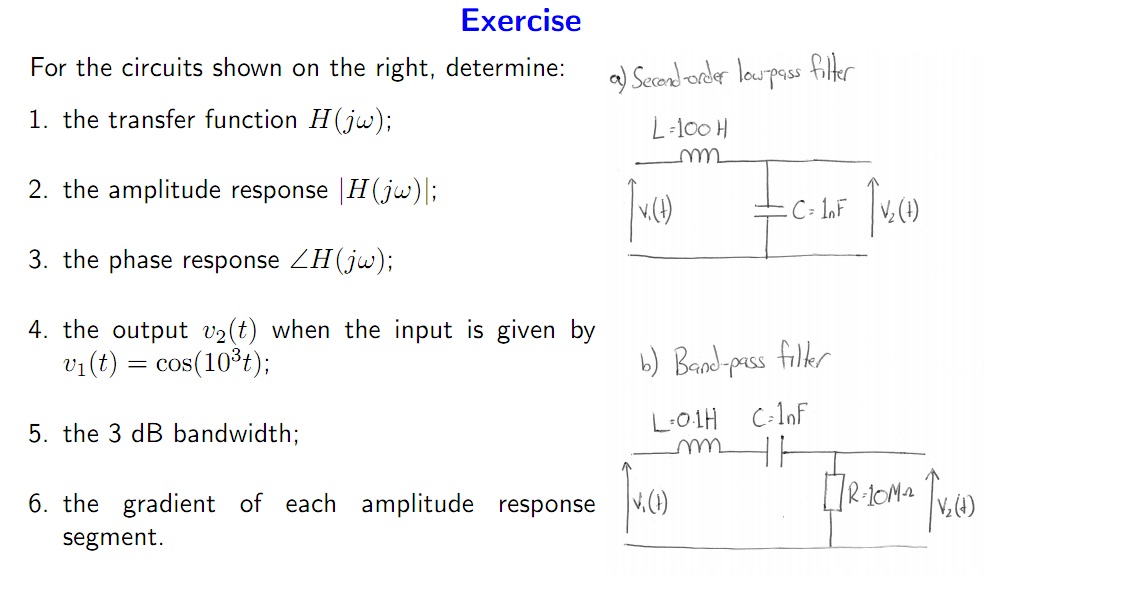

Hello guys, I just tried to answer the questions attached...
I have also attached the solutions for part a) but I got a negative answer for Wo^2, am I doing anything wrong?
Thanks for your input :)

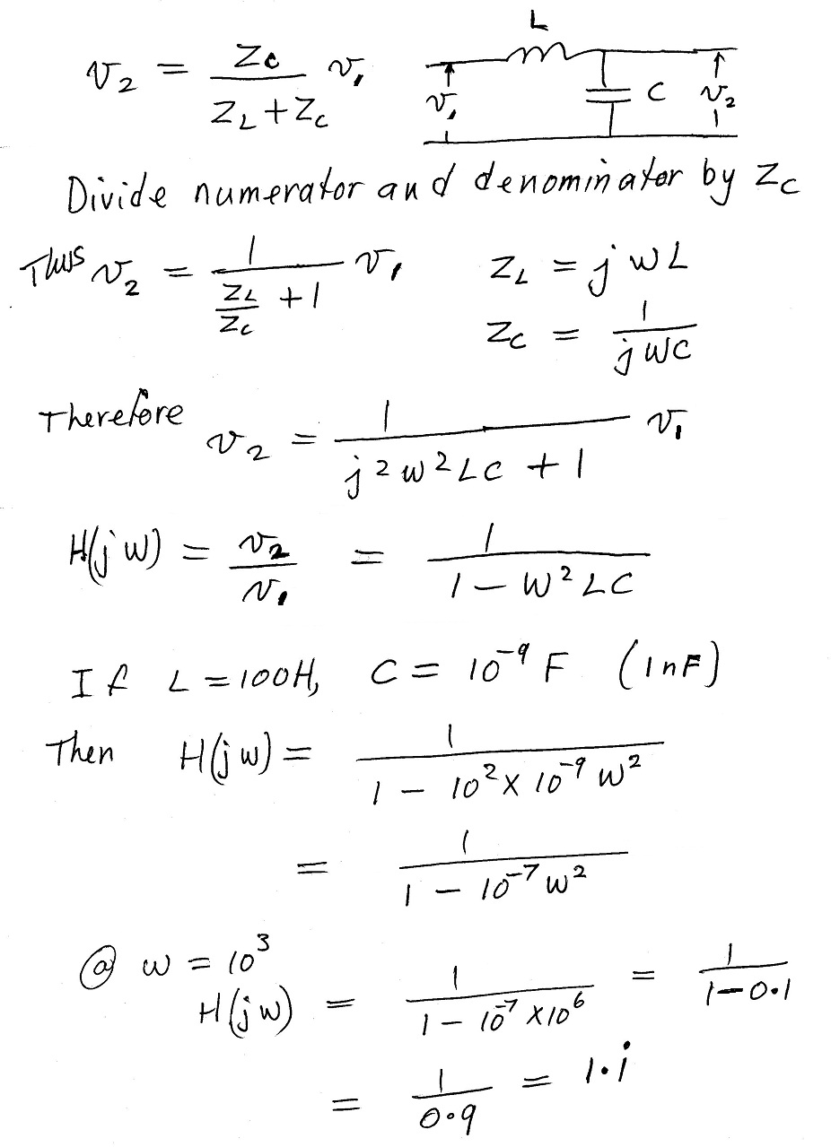

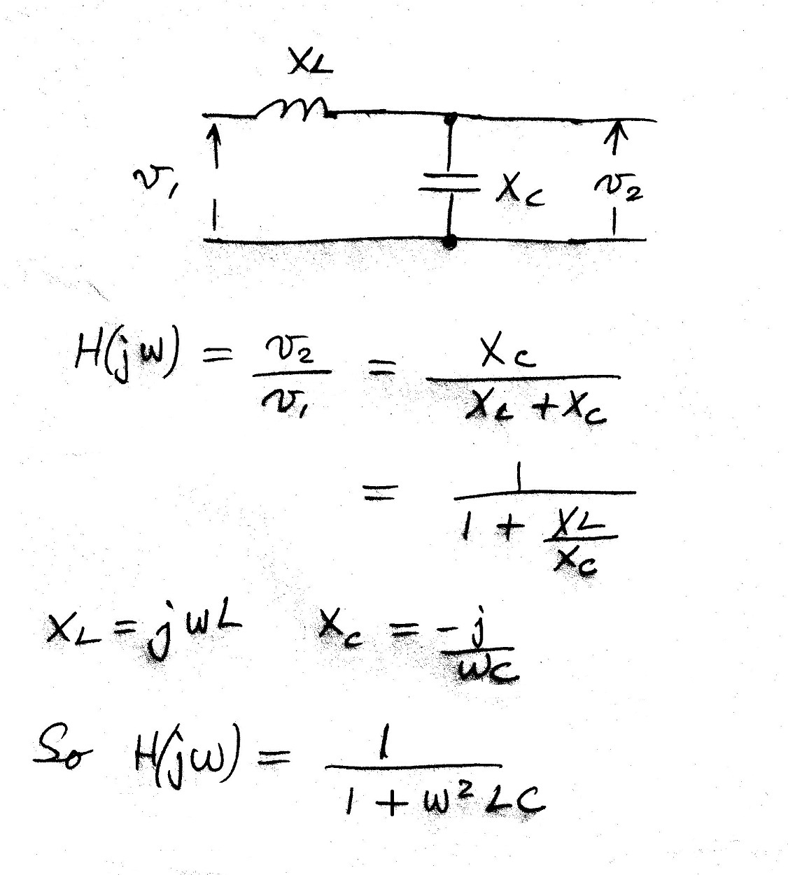

I have done the H(jw) only.
It should give you a starting point.
Thanks for the reply!
Umm I did get that result. If you take a look at the Solutions PDF you'll see that when I try to re-arrange it for wo then I get stuck because wo^2 = -4.142x10^6.
In order to get w0 we do: |H(jwo)| = 1/sqrt(2) *|H(jw)|max
when w = 0 then |H(jw)|max = 1
Thus: |H(jwo)| = 1/sqrt(2)
and now solving for wo (as shown on your equation):
1/(1-Wo^2LC) = 1/sqrt(2)
which means
Wo^2 = -4.142x10^6.
And thus my problem...
Hope you can help!
emm you sure?
If we do this:
H(jw) = Zc/Zc+ZL
H(jw) = 1/1+(ZL/Zc)
And since ZL = jwL and Zc = 1/jwC (same as -j/wC)
then ZL/Zc = -w^2LC
So H(jw) = 1/1-w^2LC
same as before? or did I go wrong somewhere with my signs?
Yes, you're right.
I re-checked it this morning & found it is a negative.
BTW jwL & -j/wC are reactances, not impedances.
I'll now re-read your .pdf.

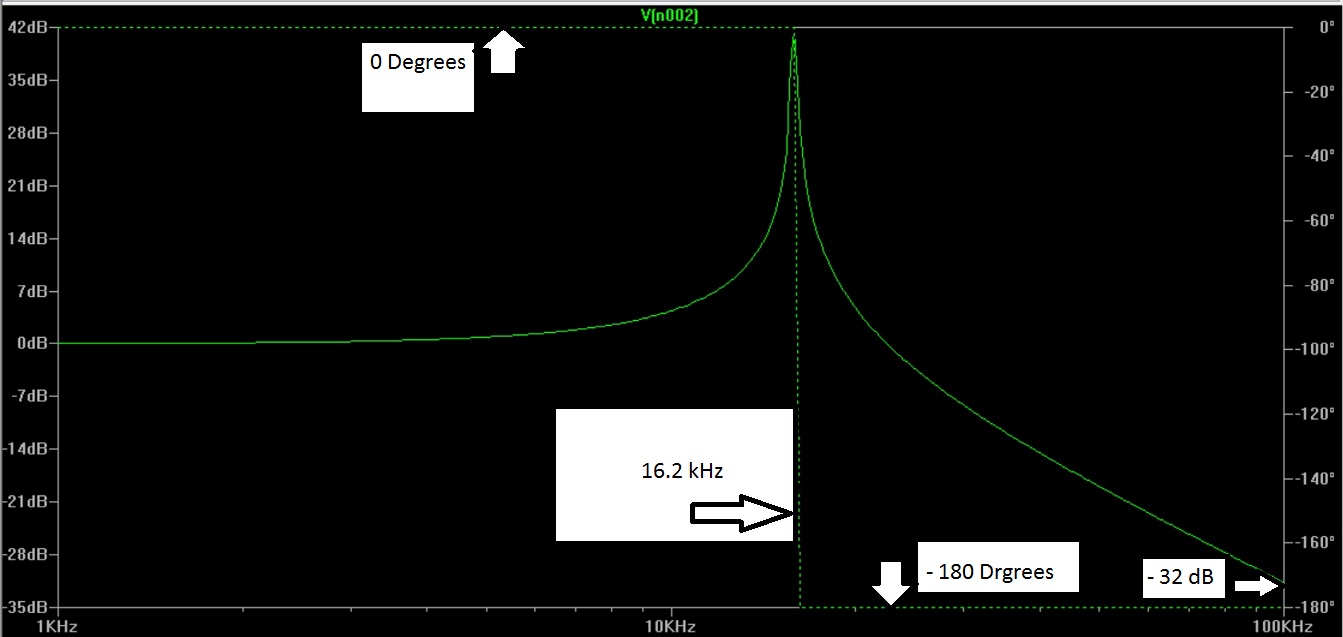

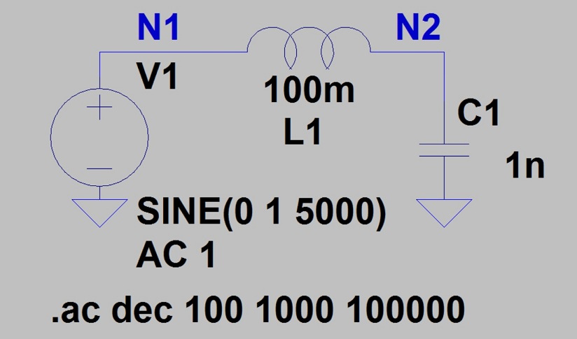

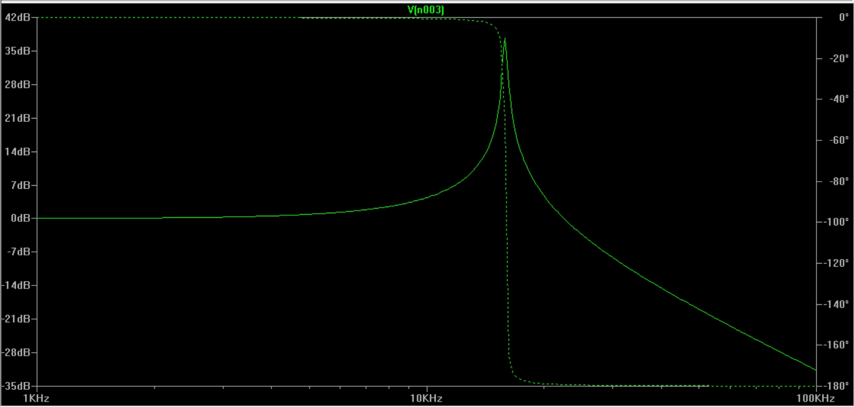

I did a simulation see attachments.

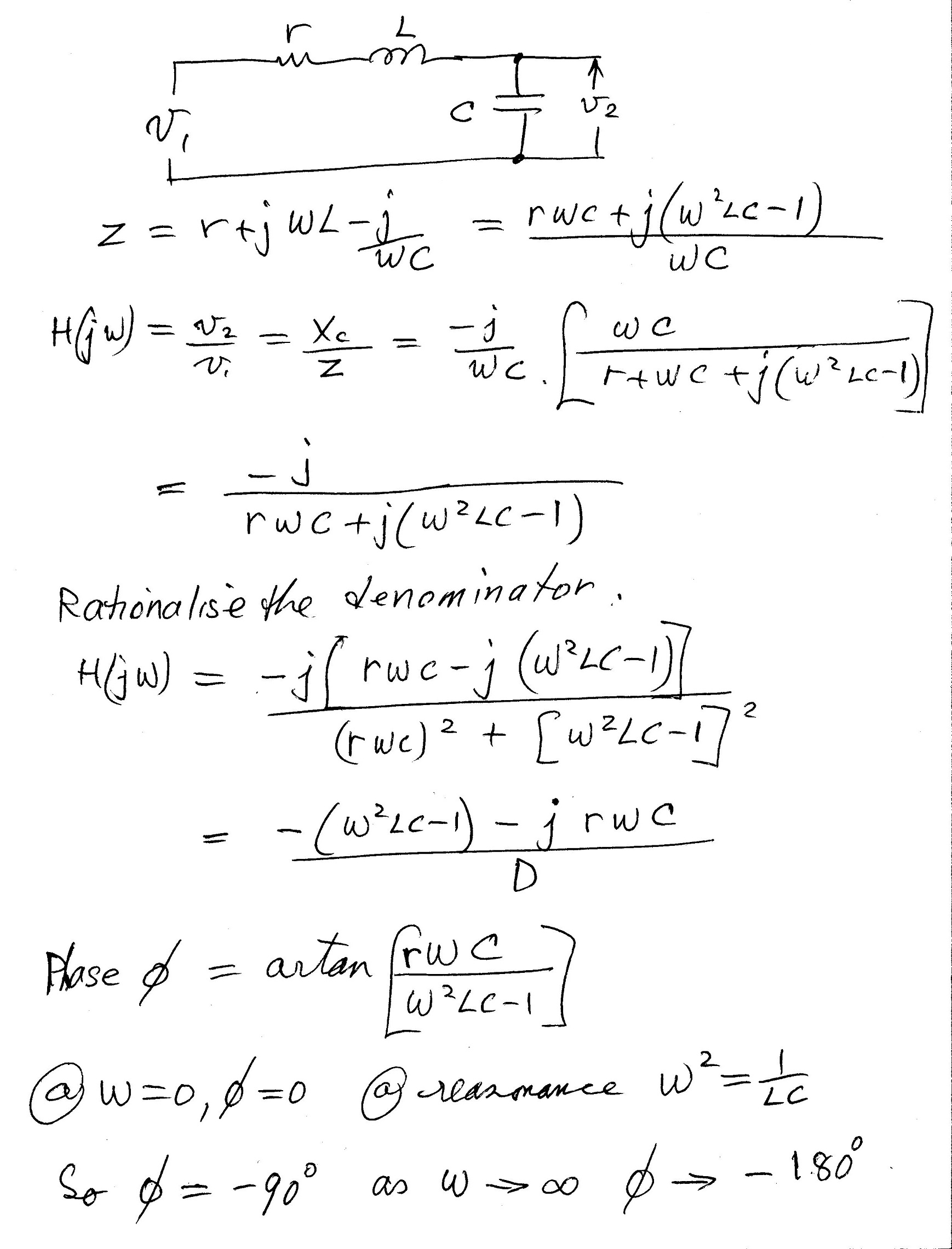

I put a 100 Ohm resistor in series with the inductor and the simulation is attached.
I have now done the maths for this case. The phase angle agrees with the simulation.
But I have only done it at ω = 0, ω = 1/LC (reasonance) and as ω > ∞.
It is a long time since I did jω calculations, so I'm a bit rusty.
I hope this helps. You can set r = 0 for your situation.

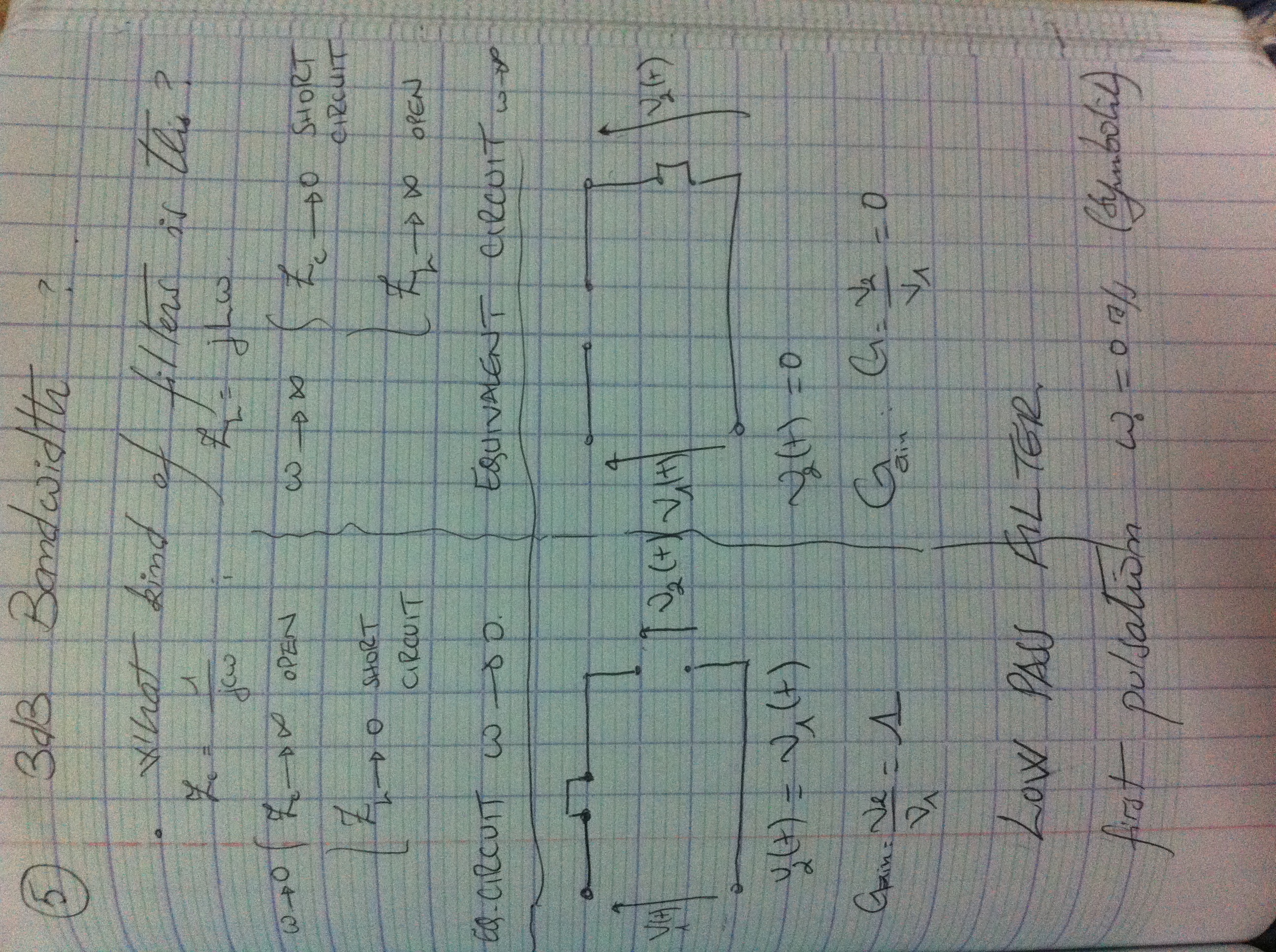

Hello,```
It's been ages I didn't work with those ..
If there's any incorrect technical terms or something, feel free to correct me.
The attenuation is 20Log(YouKnowTheDrill)..
EDIT: To be read in the order 1, 3, 2, 4, 5, 6
All my best,

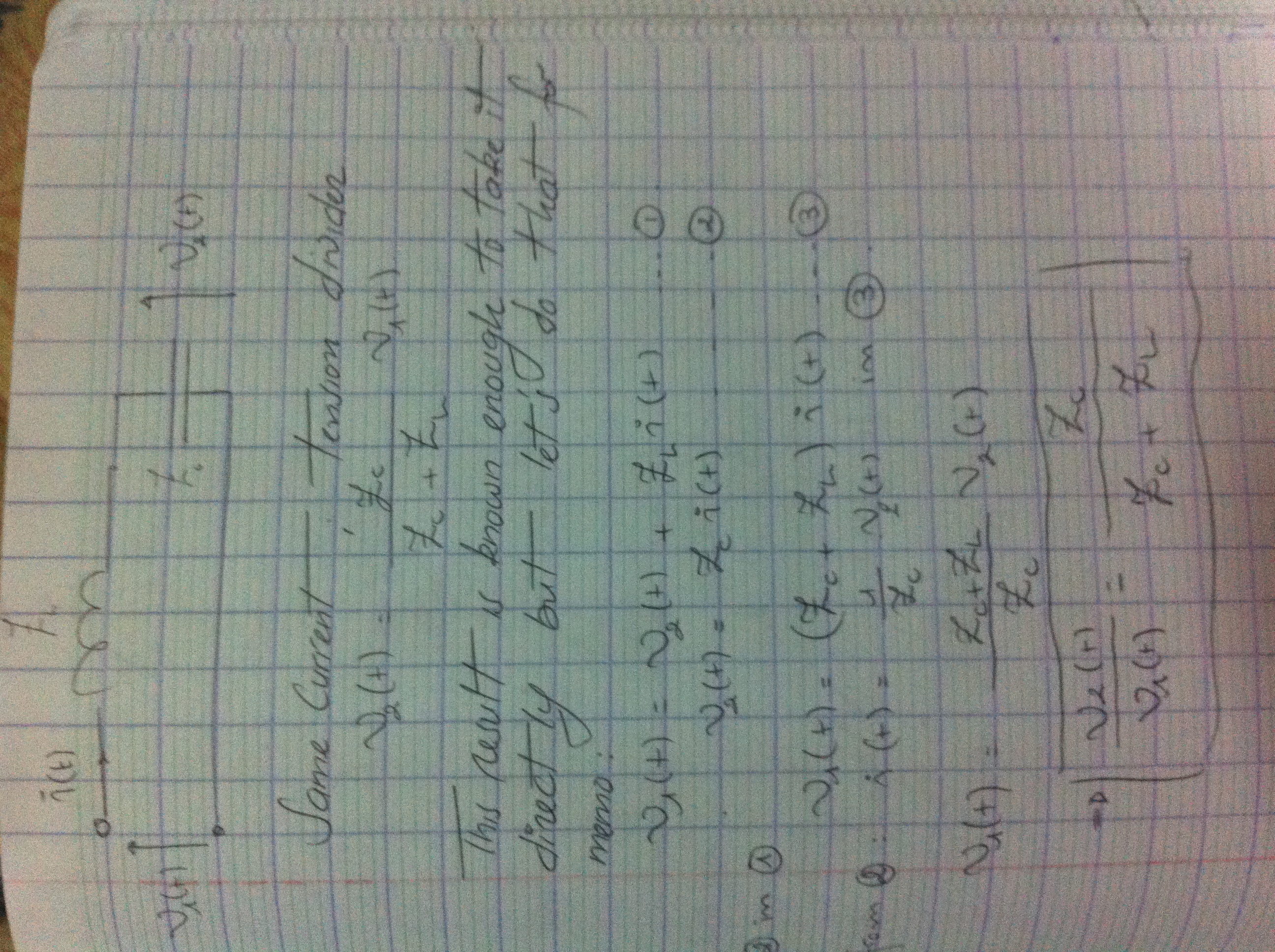

Here is my version and I have inserted some comments & questions on your 4.jpg.

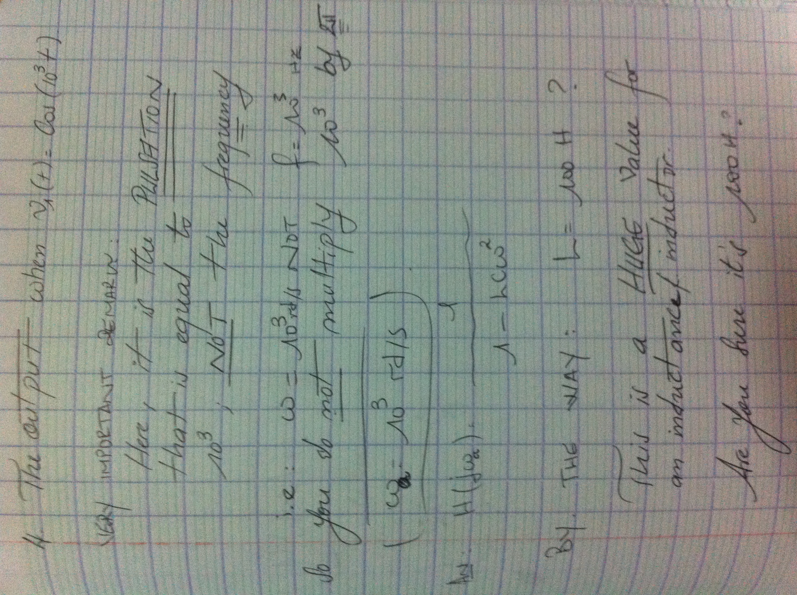

Hello back,
The answer is really simple.
It is 1/(1-10^2*10^-9*10^6) , right ? .. This becomes 1/(1-10^-1), right ?
What happens if you multiply the Num and Denum by 10 ?
It becomes 10/(10-1)= 10/9. Voilà.
You can do it anyway, really.. Your version is obviously correct..
I like putting results as nice clean fractions, and only calculate their value at the moment where I need the "value".
This way, anything that can be simplified, like 9/2 * 2*220 will be simplified so you don't use your calculator unless you "have to"..calculation time is diminshed.. ERRORS are diminished both in involontary mistakes AND in error propagation.
