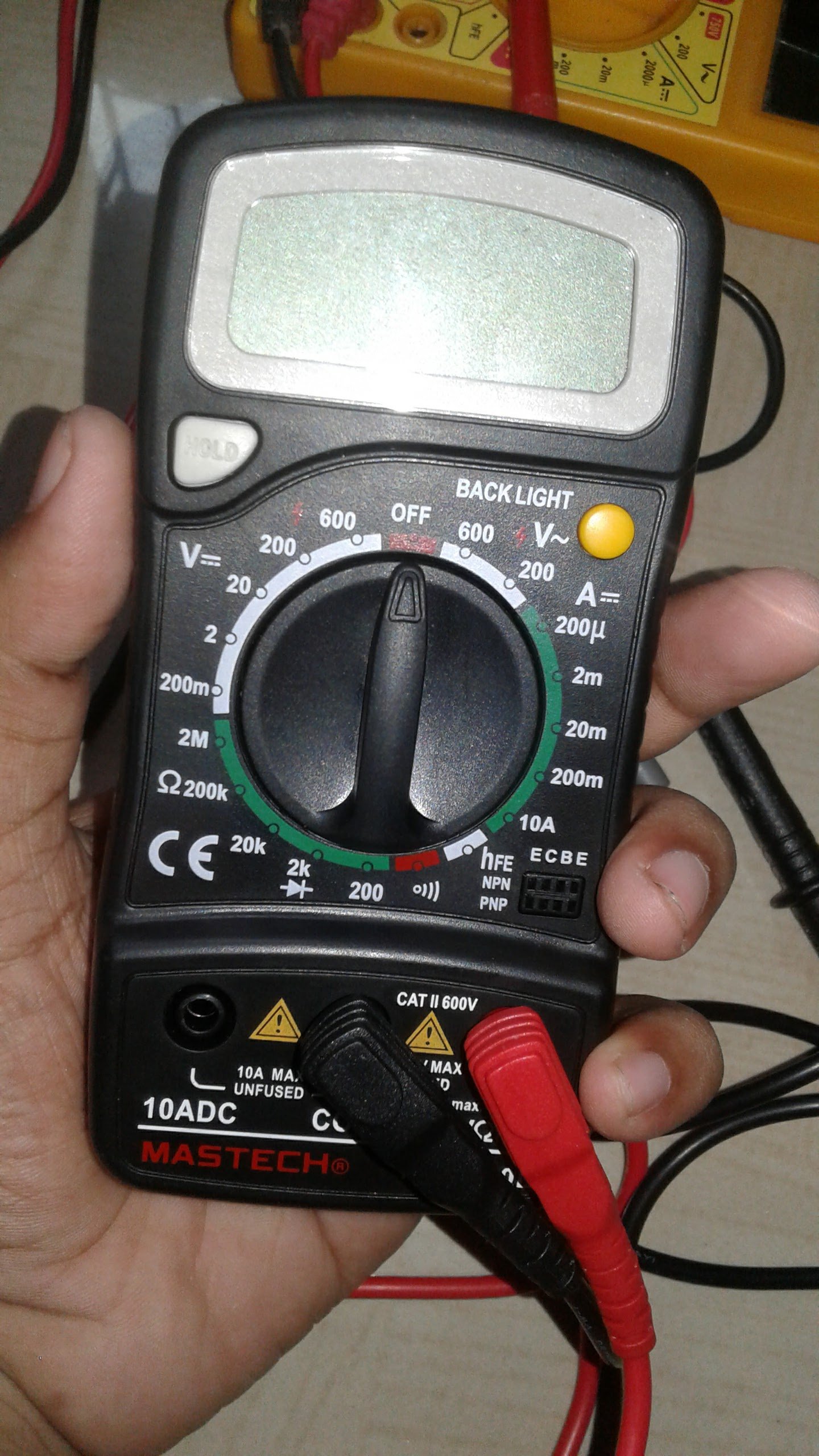

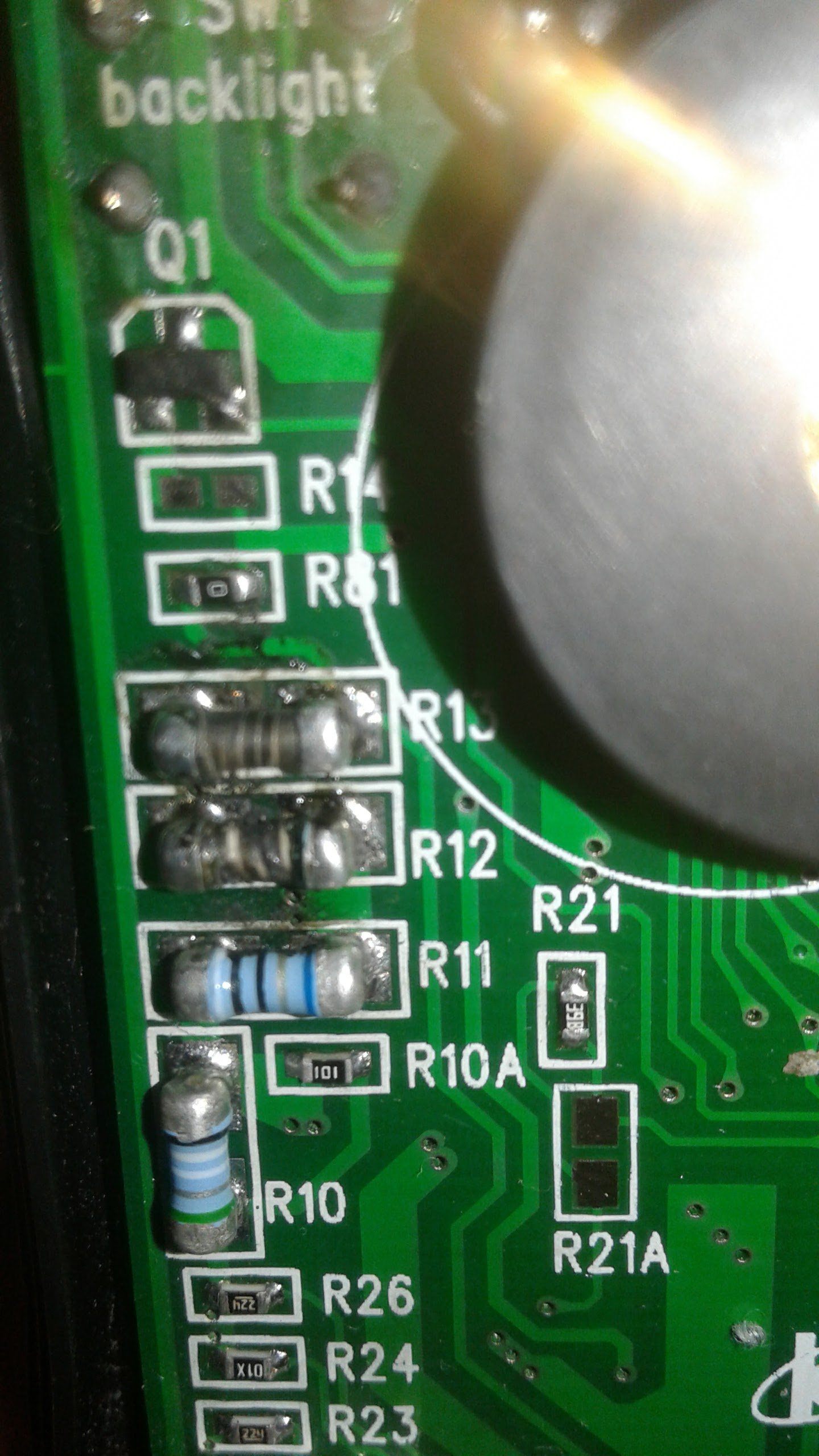

    i connected my mastech mas830l directly to the wall outlet to measure amperage thus burning.. now what should i do? 20170917_074840.jpg

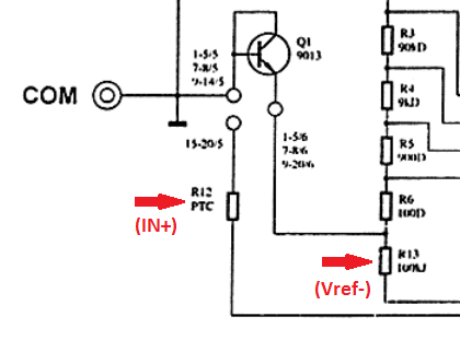

    Back to the present, presumably you want to try to repair the meter (MAS 830L ). Q1 is a transistor. That meter is quite popular and its schematics are on the internet. Here is one of several examples: http://airborn.com.au/circuits/mas830l.gif
    It is possible a generic transistor and the other component values are also available.

    but i want to repair it ...all others are working like i can measure wall outlet voltage,,,actually i know to measure current i need to put the leads in series with the component to check the currecnt drawn ...the thing happened is tht i connected the leads to the wall outlet to measure current
    the meter was off.... one hand i was holding thge leadson the other hand i was holding the meter ...than i turned the knob... and it somehoe landed to amperage....i am from india...everything costs much...so i cants afford to buy a new one please help!!!! 20170917_074939.jpg

    You've fried the below indicated resistors:
    Just before those resistors sacrificed themselves (probably Q1 also), it is extremely likely that the Vref- and IN+ inputs to the AME7106Y processor were fried as well. And no telling what else within the μC was trashed, with all that high current VAC flying around, however briefly.
