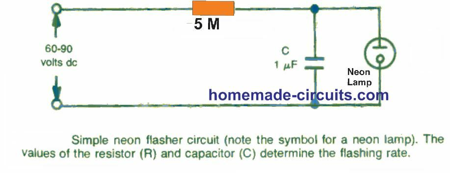

A simpler osc -

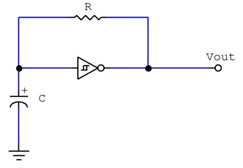

But takes a higher V to run it. A low V using simple logic gate -
