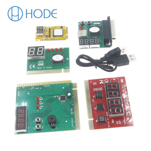

A BIOS diagnostic card - aka "POST Card" - is also very useful for faultfinding with problems such as that; many PC BIOSs will output status codes to an I/O port as they go through the stages of the hardware testing and boot sequence & those status codes can be viewed with a simple plug-in card that has a LED or LCD display.
This ebay listing illustrates various versions for different PC bus types:
