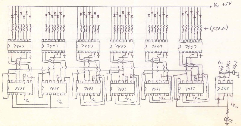

Hey! I know what you want
I've seen thos clocks, i want to build one too, i know how to do the clock, but i need to find a good (precise) oscillator for the seconds!
In junior high i did this clock with some 74**'s but the oscillator was a 555 and of course a pain in the ass to adjust it, it would run early a couple of minutes every few days...
All we have to do is get rid of those 7447 (Digit encoders) and use the 7493 outputs directly to get our bits... Also, modify the reset inputs for the last 7493's to get militar or standard time...
Could someone please comment on the circuit (i.e. if we should be using something better than 7493... etc.)
And please give us a precise 1 Hz oscillator!!!!
I'll redraw the circuit and send it as we should use it soon.
Sorry for not having posted the diagram yet...
I've had a lot of work, but i'm working on it.
Anyone, ideas on the "seconds" oscilator? thanks.
I would use a oscillator module (give it VSS; VDD, and a fixed freq comes out)...
You won't find one of 1Hz tough. But you can divide the freq. with counters

I've been wondering for how long would a common battery supply a circuit like the one drawn above... any idea?
What would be the most efficient means of getting those 5V?
How much current can a 7805 give me???
Thanks!

If you use LED's then a battery won't last long... Leds don't really use much energy, but it's a lot of leds...
7805 can give approx. 100mA uncooled, and should give 1A cooled (but it is best you don't go that high)
It also depends on what voltage you have to start with... if you use the 7805 to regulate a 9V supply then he will be able to deliver more power then when you want to regulate a 24V supply.. simply because the 7805 will have to 'get rid' of more power and get hotter in the latter case...

Actually that's what I was planning on... a 9V battery.
Do you really think it's a lot of led's?

I thought you were going to make the scematic above with 7-segments
20 Leds shouldn't be a problem...
If you give each led 10mA (+- 330ohm resistor @ 5V) then 20leds will draw 200mA. 7805 Can deliver this, but remember to add a heatsink
This is for normal leds...
If you use blue leds or other superbright leds then current consumtion will rise
Ok, now, I have the 2Hz oscillator, the flip flop to divide it into 1Hz, the power source...
Will it be ok to use the 7493's? or is there a better option???
thanks!
Save power
If you abandon the 7400 series and use 4029 counters you will save power
(important if you want to run from batteries)
and avoid a 5v regulator - everything will be happy on a 9v supply (but why use 9v? ... see later).
Are you planning on 12 or 24 hour format ? (or switchable???)
At 17:37.37 this display will light 14 LEDs - at 10mA/LED = 140mA
At 00:00.01 there will only be a single LED on .... 10mA
A stack of 'C' cells may give a life of 4 days or less ...
A stack of 'D' cells might double this - 160 hours
I guess you will be buying new batteries twice a week then ?
Are you sure you want this to be battery powered ?
If you use batteries then you want to keep the voltage as low as possible -
Every LED has to have a series resistor, any resistor will dissipate (waste) energy.
The lower this dissipation is the better your circuit's efficiency,
a higher voltage means a bigger resistor and more wasted power.
