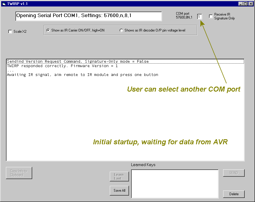

This implementation sits between the IR detector and PC host serial port. Not only does it logs and shows the timing between each logic level changes it also draw up a nice graph on the PC showing the waveform shapes. This helps to identify the remote codes variety easily.
I have made minor cosmetic changes to the result display and the following animated GIF shows the operation of the setup, recording a capture from a NEC remote control that I have.
Besides showing you the timing data, it also decode it into several bytes. It has other added features like assigning user defined key records to received IR signals so one can later play them back as if they are coming from the original IR remote control. I have not tried them out yet.

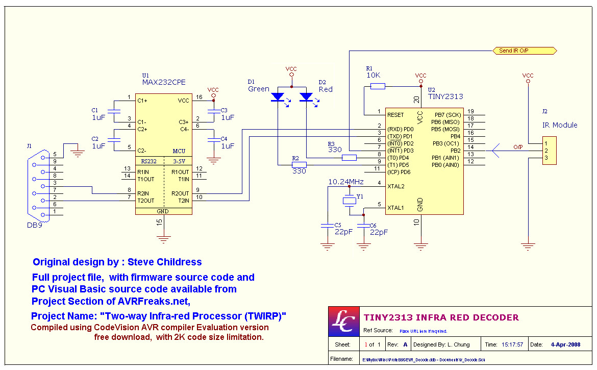

Unfortunately, the author did not include a schematic in the project file so it might create difficulties for someone else who wants to build it. I therefore provide my own schematic I "deduced" from the C source code definition of AVR pins. The original design uses a AT90S2313 but I drew it as a Tiny2313 instead because the AT90S2313 is now hard to find.
The original design uses 10.000MHz crystal which I don't have so I changed it into using 10.240MHz instead. I have also changed the communication baudrate from 19200bps into 56700bps. This would require changing both the AVR firmware and the associate Visual Basic Code so one would be better off starting the project with the original code provided by the author before making any changes.
You would need the CodeVision AVR compiler too but an evaluation version can be downloaded from the manufacturer's site which does have a 2K code size limit. Perfect for use on Tiny2313 which has only 2K program memory.

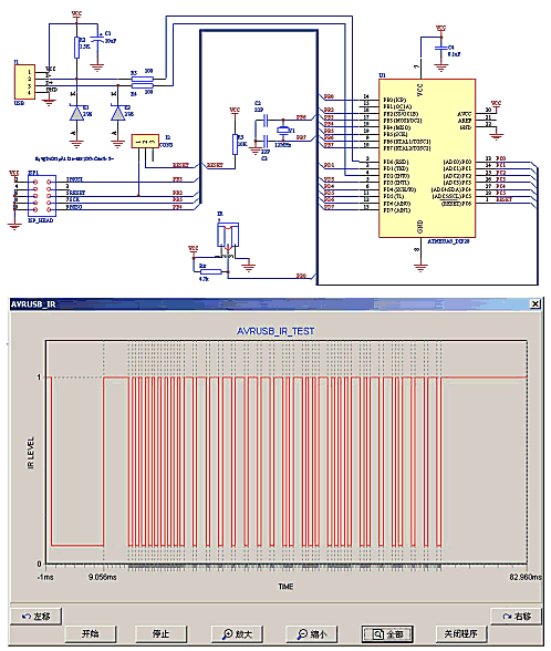

Subsequent to my posting, I have located another huge AVR user site in China in which an user has built the same with a Mega8 and communicate using USB instead.The USB hardware interface is done in the Mega8 using the popular USB firmware from obdev so no other chips are needed. The IR timing capture is done via the capture pin of the Mega8 timer.
All one need is a Mega8 AVR, a 12MHz crystal, a IR module and a few resistors.
The PC HOST interface collects the data from USB, graphs it with timing data and allows zoom in and out on the captured waveform. Just learning how one can do that using software is rewarding.
The kind author "lzf713" has provided all the information like source code and HEX for AVR firmware, EXE and C++ builder source code for HOST software for free downloading. Just look for the file "ourdev_196057.rar" near the top of the webpage shown in the link below.
Projects like this are a tremendous gift to every hobbyist because it provide insights into how different parts of an useful application are being linked together. It is the process that one learned during the making of the project.
Thanks lzf713 again for sharing.
Link for original article & software

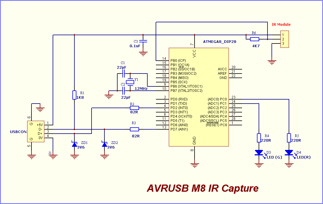

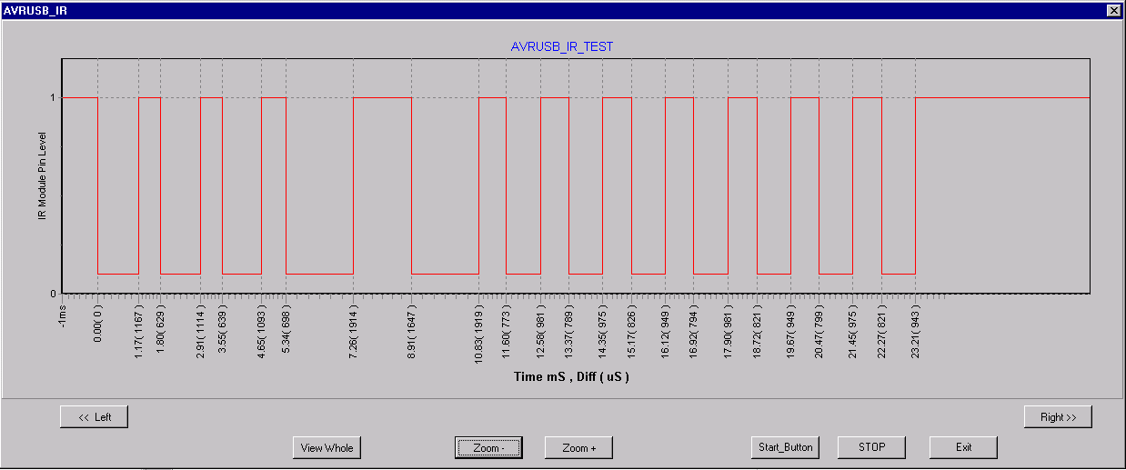

I have built the AVRUSB_IR project above using a Mega8 with a 12MHz crystal.
The image is the result of a capture using my RC5 remote.
