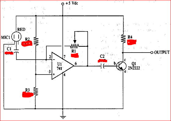

I found this with 2 clicks and some scrolling (using the above suggested google query phrase):
This is, at the least, a starting point and uses the devices you listed. Component values are for you to figure out. Also, this uses an electret condenser microphone for an input. Just eliminate from the circuit and substitute with your 200Hz sinewave.
And no inductors needed.

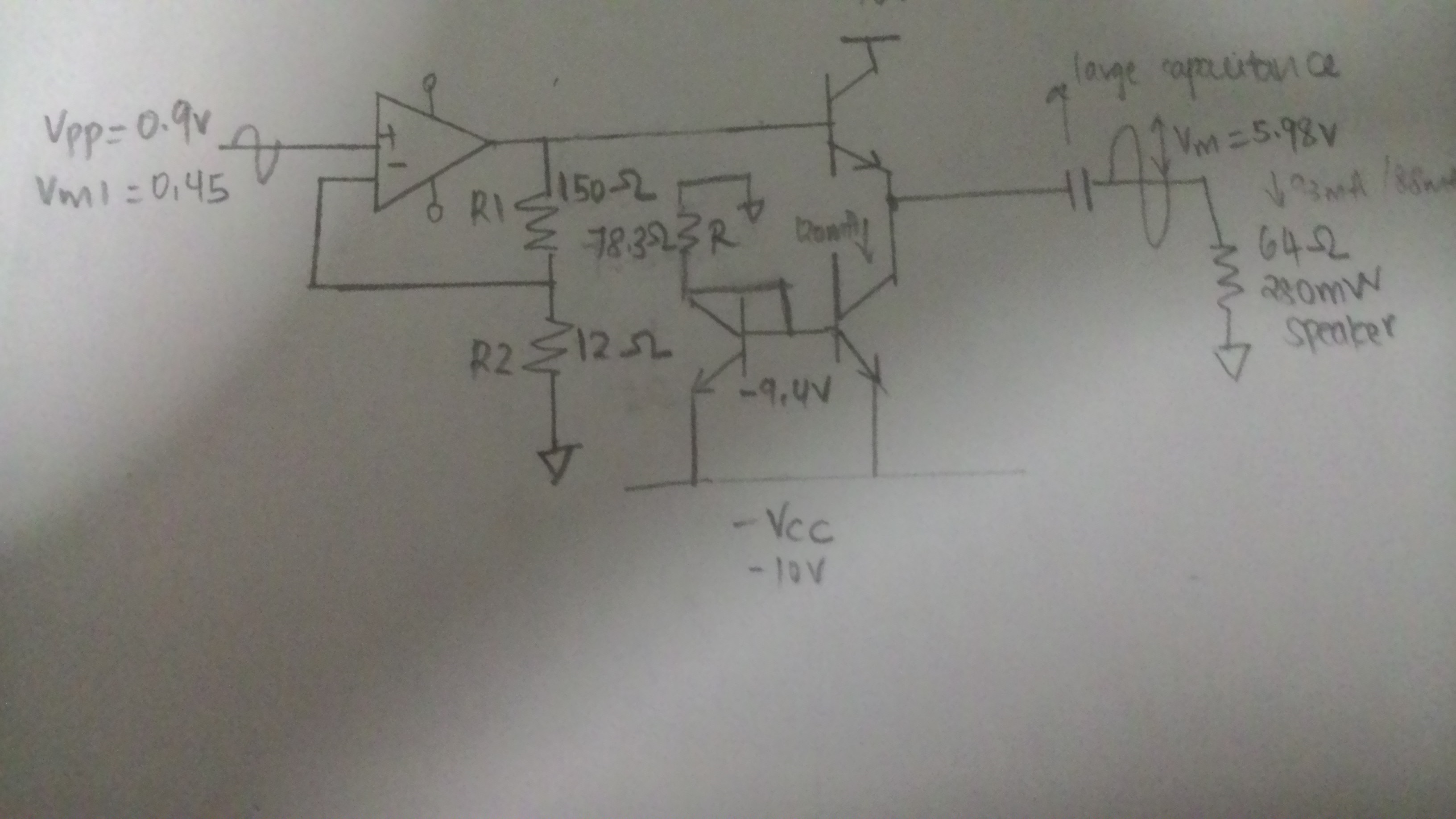

hi everyone,
thanks for your guidance.
I am provided with 2N4921 npn power transistors, 64 ohm speaker (rated o.5W).
I have attached a circuit for the design problem stated.
Kindly, could you help check the schematics, are all resistors values correct and what capacitance value I should use?
I need to submit tommorrow. please help!!!
Thank you.

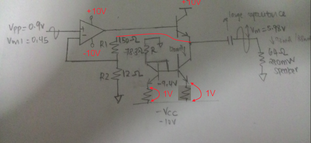

+10V supply and -10V supply
Feedback is OK but better after the transistors. (please tell me why)
Current mirrors do not work as well in real life with real transistors. So I added emitter resistors that should have about 1V across them. This will help reduce errors because the two transistors are not exactly the same. (please think about this. Why emitter resistors help)
I did not check if you have enough current. 78.3 ohms is strange value. Probably not critical as long as you more than enough current. (peak current)
You have about 10V across the 78.3 ohms. So the emitter resistors could be 1/10 that value.

I am using three bipolar 2N4921 npn power transistors. with a signal of 2kHz sinewave with a peak-t0-peak amplitude of 0.9v.
feedback after the transistor as to ensure the voltage is higher than 0.
emitter resistance are placed to prevent the transistors from saturation.
Am I right?
Can I use emitter resistors of 10 ohm?
R value of 82ohm or 100ohm instead of 78.3 ohm?
what capacitance value I have to use?
Why does the teacher ask the students to design a power-wasting class-A amplifier?

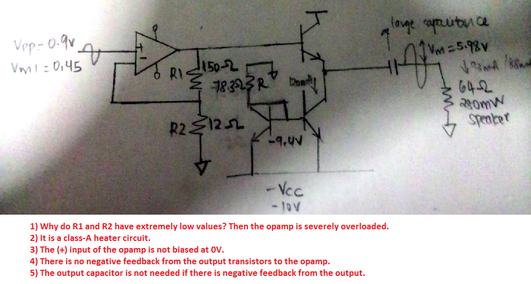

I noted a few problems with it and suggestions to make it better:

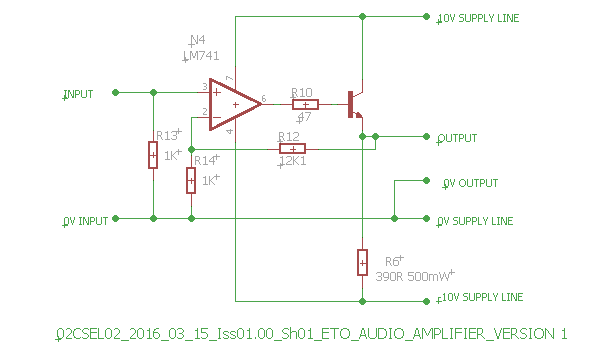

Hi e-le,
This is the simplest circuit I could come up with to meet you projects objectives (errors and omissions excepted).
spec
ERRATA
(1) The transistor should be named Q1 and labeled as type 2N2222
NOTES
(1) R10 has no functional purpose. It is just there to give a degree of isolation of the 741 opamp from the input of the emitter follower transistor.
(2) Decoupling capacitors on the opamp power supply lines have not been shown. On a practical circuit these would be required (100nF minimum from each opamp supply pin to the 0V supply line)
(3) The input impedance of the amplifier is 1K Ohms. This can be changed if required.
(4) The voltage gain of the amplifier is 1+ (R12/R14)
(5) This is a class A amplifier. Even the 741, which normally operates in class B, will be operating in class A. Because of this the amp should sound quite good. To improve the quality more a 10K Ohm resistor could be connected between the opamp output pin and the 10V supply line.

The transistor will pull up the voltage to the speaker positively very well but the 390 ohm resistor R6 will do a very poor job pulling down the voltage to the speaker negatively.
Or are you connecting one wire of the speaker to the -10V supply?
