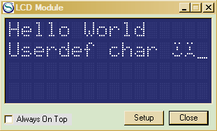

Ive been working on my LCD code, which I had working at one point, on its own. I then tried to port this LCD code into the other code ive been working on and now all I get is solid boxes on the top row of the LCD.
Ive pasted my code below, can anyone see a reason why the LCD might be doing this? Any help or advise would be hugely appreciated.

I cant read this code but i know that the problem will be in the initialisation of the LCD display. Not sure if this will help much.
I know that it will probably be the initialisation but I copied this code across from the old working code and when I ran through the code in MPLAB it seems to run through the initialise correctly
Check to see that your ported code agrees with the new hardware. Check again. The TRIS registers too.
Your are sharing the PORTB between the LCD control and the stepper motor. Make a copy of the program and comment or edit out all code for the steppers. Can you get the LCD to work without it?
Ran your program in Oshonsoft, it initialises and displays correctly, BUT its running much faster than I would expect when using the programs real world delays for initialising.
I would guess that the LCD INIT delays are much too short a duration for a correct initialisation.
EDIT:
Further checks on your program show that the 15mS power on delay is OK, but the 40uS delay for writing the LCD commands is too short.
The LCD manual states 15mS, 4.1mS then more than 100uS for each delay in the initialise sequence before writing the set up commands
I usually write 0x38 after each one of these delays, then the init commands, never have any problems.
