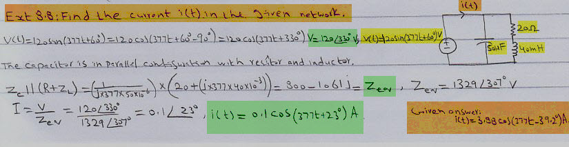

AC RLC circuit problem, IrwinExt8.8
PG1995
Active Member
Hi
Please have a look on the attachment. My answer doesn't match with the given answer although I have checked it several times. Please help me with it. Thanks.

Thanks a lot for giving it a look. I have solved it. I made a very childish and silly mistake! :( I'm sorry.

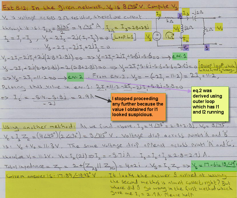

applying KVL and phasors, ExtIrwin8.12
Hi
Please have a look on the attachment. It has my query there. Please help me with it. Thank you.

Writing a little hard to read, if it was typed out it would be much easier to read.
However, a quick look, i have to wonder where you came up with the 2.8 from. If it is because the amplitude is 8, then shouldnt it be 2*2.8, or more exactly, 2*sqrt(8) ?
Also, another approach which might be a little interesting is to solve this circuit backwards. If Vo was the input and Vi was the output, you could easily solve it, right? By 'backwards' though i mean to solve the circuit 'forward' the way you normally would, then simply solve for the input rather than the output. Writing it forward you'll come out with the same equation as if you were solving for Vout, but then solve for Vin instead of Vout as the following will illustrate:

Actually I had made an error at the very end. Now I have corrected it. I really appreciate your input.
